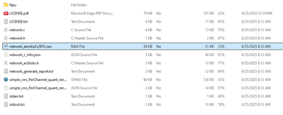

The network_data.hex comes from the network_atonbuf.xSPI2.raw
The .raw file is an intermediate format containing model data, and you need to use the ST Edge AI tools to compile it into a .hex file that's ready to flash onto your STM32 device.

Concerning the stedgeai core 2.0, the npu addon is indeed not available anymore. It is not advised not to use the latest version. If you still wish to install it, you can find it attached

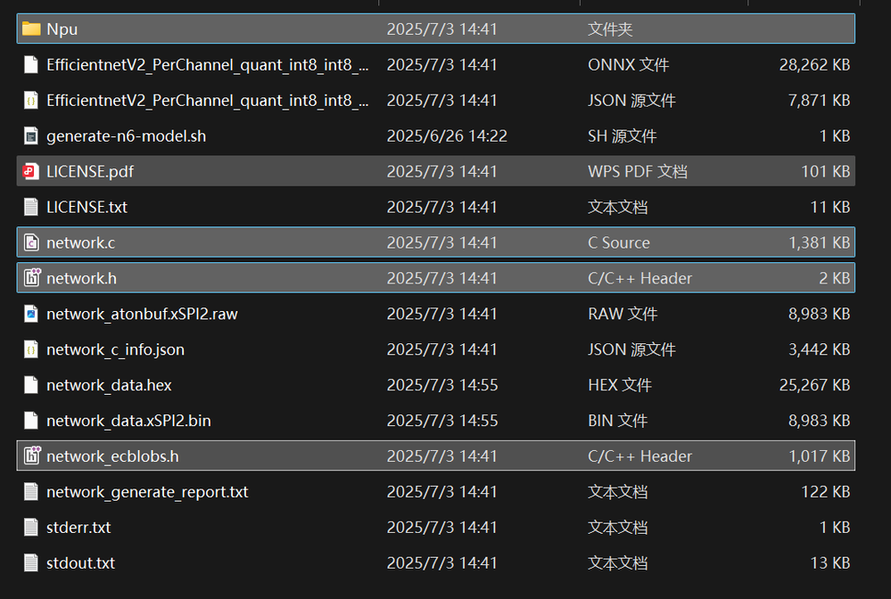

Previously, when I used the ST Edge AI program (invoked via the command line on the terminal) to generate model weight files (hex files) and files such as network.c and network_ecblobs.h for my model, it simultaneously generated the following files for me (see the pictures in the attachment).
Currently, I only copy network.c and network_ecblobs.h into my project, and then add some files to the Middlewares\ST\AI\Npu\ll_aton folder. Similar to ll_aton_reloc_network.c and ll_aton_reloc_network.h. This Project can be compiled normally. After adding the header to the bin file in the Appli\Debug folder and generating the project-trusted.bin file, network_data.hex and ai_fsbl.hex, and burning them into the stm32n6 development board, it can work normally. However, the effect was very poor. The recognition model I deployed could only identify a few items, and the probability of the neural network output was only around 10%.
I suspect that it might be because I didn't put all the files generated by the STedgeAI tool into the project that the model deployment effect was not good

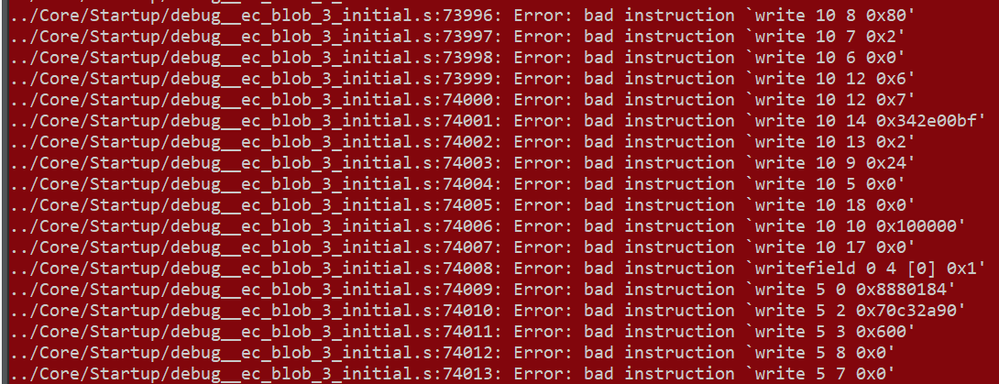

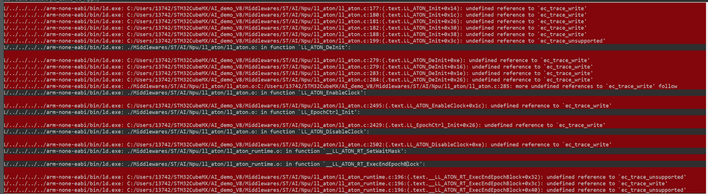

I tried to put all these files into my project, but it couldn't complete the compilation.The possible errors it might encounter are as follows:
I also tried to use the web version of stedgeai and the X-CUBE-AI tool on stm32cubemxto generate c files, header files, and weight files for my model. I copied all the files generated, including the NPU folder, into the project. However, after the project was deployed to the development board, it did not work. The item labels displayed on the lcd would not change, and the probability was 0.
I feel like I've hit a dead end, but I only have a few days left to complete this project. So I'm in urgent need of your help. If you have time, I sincerely hope you can offer me some advice as soon as possible.Anyway, I'm very grateful for your assistance.

Hello @Lipi,
I don't know how you created your project, but based on the input/output shape of your model, you seem to do image classification.
I would suggest to either use image classification use case in ST model zoo or use the image classification getting started to use your model.
If you use the model zoo, you should be able to easily generate a project with camera pipeline and LCD display just by configuring a .yaml file and running a python script.
Model zoo install: GitHub - STMicroelectronics/stm32ai-modelzoo-services: AI Model Zoo services for STM32 devices
Model zoo image classification deployment: stm32ai-modelzoo-services/image_classification/deployment/README_STM32N6.md at main · STMicroelectronics/stm32ai-modelzoo-services · GitHub
Getting started image classification (look at the /doc): GitHub - STMicroelectronics/STM32N6-GettingStarted-ImageClassification: An AI software application package demonstrating simple implementation of image classification use case on STM32N6 product.
