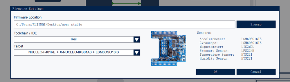

Software environment: cube ide project generated with MEMS-STUDIO. configuratin file inside ISPU is F:\en.x-cube-ispu\Ispu\ism330is_lsm6dso16is\sensor_fusion_9x\output\sensor_ fusion_9x.ucf.

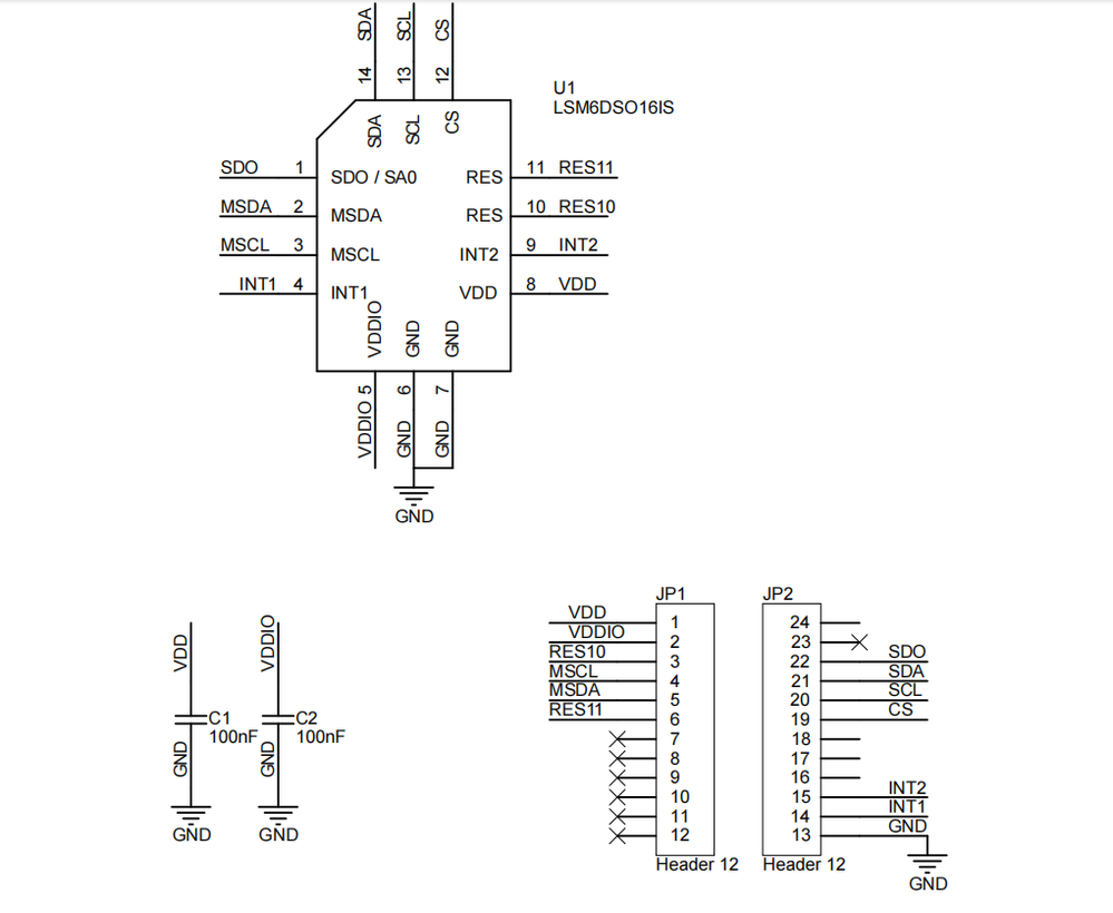

1. I understand that the IIC pin of the geomagnetic sensor LIS2MDL should be connected to the MSDA,MSCL pin of the LSM6DSO16IS, and the LSM6DSO16IS takes the initiative to read the data from the LIS2MDL, and then the ISPU generates the 9-axis data with geomagnetic information. However, when I read the production project code, I found that the LIS2MDL data is read/written through the IIC interface of F401 microcontroller, which is mounted on the same iic bus as the LSM6DSO16IS, if so, how can the ISPU get the geomagnetic information to generate the 9-axis data?

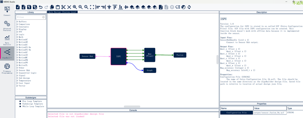

2. en.x-cube-ispu\Ispu\ism330is_lsm6dso16is\sensor_fusion_9x\output\ shub.ucf How is this file used? This is supposed to read and write geomagnetic data via the master iic of the LSM6DSO16IS, but the algobuild in MEMS-STUDIO does not use this file?
3.How does the 9-axis output of the ispu function perform geomagnetic offset correction?

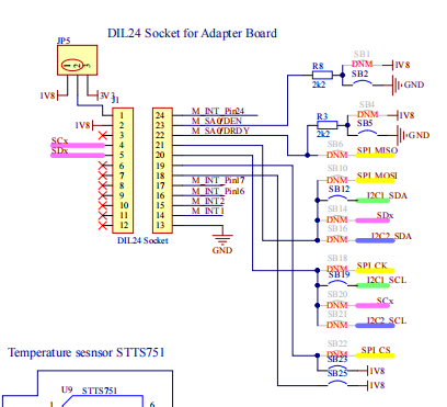

The AlgoBuilder firmware expects magnetometer sensor connected to primary I2C but so this trial will not work with AlgoBuilder firmware
In order to connect the LIS2MDL magnetometer on IKS01A3 to LSM6DSO16IS (in DIL24) sensor hub interface, some HW configuration must be done.
See the user manual UM2559, page6 (connection in mode 4), in this way the LIS2MDL is connected to the DIL24 in sensor hub mode (JP7 and JP8 in 2-3 position and SB12, SB19 disconnected, SB16, SB21 connected).

In MEMS Studio two ISPU configuration needs to be loaded shub.ucf to configure sensor hub, sensor_fusion_9x.ucf to program ISPU with 9-axis sensor fusion algorithm,  then it should be able to stream the data to MEMS Studio application.
About the magnetometer calibration can you try to see the readme file in the git hub repository of sensor_fusion_9x.
