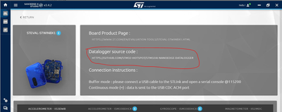

I downloaded the STM32-NANOEDGE-DATALOGGER firmware via the github link.
This STM32-NANOEDGE-DATALOGGER is used in NaoedgeAIStudio and is streaming data via UART (VCOM port) from STLink.
but I see that the example is only given for an AD (Anomaly Detection) project and I'd like to know how to modify it for an n-Class project?
Also, is it possible to add the USB_CDC_ACM  class to activate the VCOM port on the STWIN.box without the STLink?
If so, how do I do it?

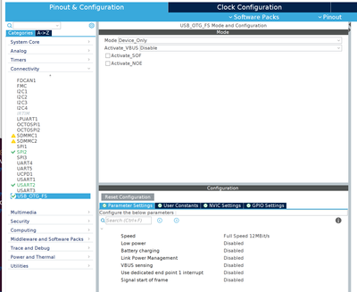

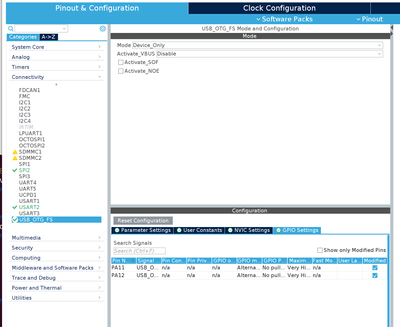

First, you need to configure USB_OTG_FS in Device_Only, see below:
Then look at the code attached to add it in your project.

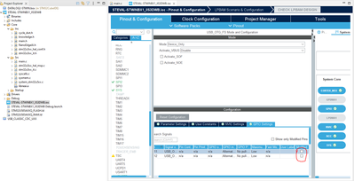

Hello @Julian E. , thank you again for your reply

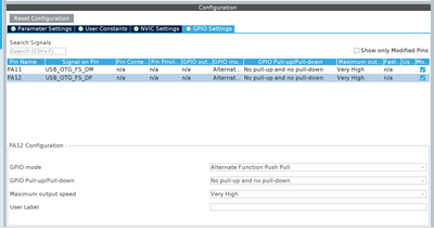

So I opened the .ioc of my project to complete with USB_OTG_FS as shown on the image. But I can't check the following boxes. Is it normal?
Then i generated le C code i realized that there is no file name "usb_device.h" like identified in the file attached in your message.
So are you open the same project from this link on image below ? or a new project?
Thanks for your help!
Best Regards
First, yes, it is normal that you cannot check the following boxes. You can click on PA11 and PA12 and change the Maximum output speed to very high:
Then for the usb_device.h, please go to https://github.com/STMicroelectronics/stm32_mw_usb_device and get:
  • Core
  • Class/CDC
Then add them to your drivers.
Best regards,

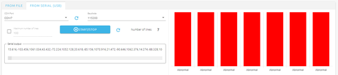

Now I'm trying to figure out how the 1_class library works. In the Emulator tab of the NanoedgeAI Studio software, I can see that the sensor indicates that the input pattern is detected as an outlier (outside the class considered), as shown in the following image:
But when embedded on microcontrollers, according to my code the orange LED should be flashing, but it's the green LED. I can't figure it out. Is my code correct? How can I retrieve the function output, which should be 0 for belongs to the class or 1 for outside of the class?
Thanks for your help.
