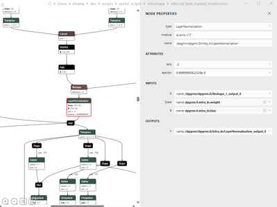

I am trying to analyze a custom Speech Enhancement ONNX model targeting STM32N6, but the tool fails immediately with an internal error.
Command executed (cmd)
stedgeai analyze -m onnx\best_trained_model.onnx --target stm32n6 --compression none --verbosityST Edge AI Core v3.0.0-20426
Tool version
Error
TOOL ERROR: index 0 is out of bounds for axis 0 with size 0
 The model is an ONNX export of a neural network used for speech enhancement. I used the code on stm32-model-zoo-services to train this model. Training and evaluation were fine, indeed i've used the .onnx that this phase generates. Then the quantization phase generate another error:
Error (symbolic_shape_infer.py)
Exception: Incomplete symbolic shape inference
What should i do?

It seems to be a compiler bug coming form the node:
_dpgrnn_dpgrnn_0_intra_ln_LayerNormalization_output_0 
In the ST Edge AI Core 4.0, the error is a bit different:
ValueError: Shape and shape map lengths must be the same: [33, 16] vs. (CH,)
The model might be malformed as the infershape fails (onnx).
This is transmitted to the dev team but will be worked on depending on other priorities.
