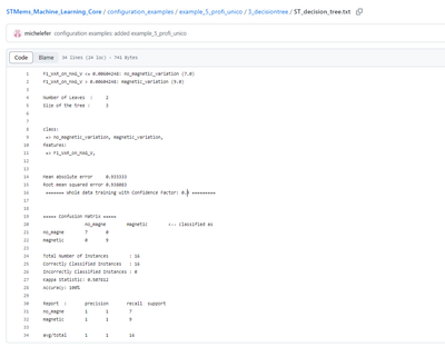

I have a question regarding the evaluation parameters for decision tree results. As you can see in the picture below, the Mean Absolute Error and Root Mean Squared Error are high, but the accuracy is also high. I am confused because I thought that low error and high accuracy are supposed to go hand in hand. Can you please clarify this for me?
Kindly,
Fehmi
Federica Bossi
Hi @FKara.3 ,
Mean Absolute Error and Root Mean Squared Error are the average accuracy in cross validation. I will point out to the team that the word 'error' can be confusing and to remove it in future releases. Thanks for pointing this out!

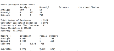

Hi @Federica Bossi ,
Perfect.
I have another question. What about Kappa statistic? Why is it low?
