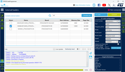

I just:
  1. cloned the repository
  2. opened stm32cubeProgrammer
  3. downloaded the weights in /binary/STM32N6570-DK_network_data.hex
    Select the external loader first:
  4. I opened the project in stm32cubeIDE 1.18.1 (Are you using the 1.19?)
    The project being in \Application\STM32N6570-DK\STM32CubeIDE\.project
  5. Then I set a debug point in main.c Run_Inference()
  6. Launched the debug
I have no issue stepping over it.
Could you confirm that it is what you did and detail the versions of the tool you are using please?
