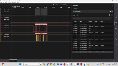

We are having SPI interface between TI C2000 MCU (TMS320F28P659DK8-Q1) and High Side Driver(L9026) the Our Target Board. Here are some observations regarding SPI communication. MISO(L9026) is not responding, not giving
  1. We are able to send data in L9026 & MISO is responding.
  2. Supply voltage of VDDIO=3.3V, VBATT=12V, IDLE (HIGH)=3.3V, IN0(HIGH)=IN1(HIGH)=3.3V,(All voltages are within the limit as per L9026 datasheet). I have attached the logs for that.
  3. We Sent in MOSI CFG_1: 0x8900 (put device in active mode, frame counter = 0).
  4. We sent in MOSI STA_1:0x4403 , but the response is 0x2201, not able to read device status register.
  5. We also checked in Idle mode too Supply voltage of VDDIO=3.3V, VBATT=12V, IDLE (HIGH)=3.3V, IN0(LOW)=IN1(LOW)=0V, in all the cases response not able to read device status register. I have attached the logs for that.

when we are giving (IN0=IN1=0V & IDLE =3.3V ) OR (IN0=IN1=3.3V & IDLE =3.3V), in both cases We are sending data in MOSI ( checking STA1  register- Global Base Address + 0x11) 0x4403 , Slave device (MISO) is responding as 0x2201.
Quick response will be greatly appreciated.
We are getting data in MISO as you mentioned. but It should be correct. We are not able read proper Device id & Status register (Data sent by Slave device (MISO) ).
Title edited to reflect this.

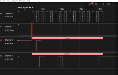

Your master has incorrect CPHA=1. Data is changing on rising edge, it should be changing on falling edge.
Dharam
Hi, Thanks for your response. Now L9026 is working. one observation, when we are sending MOSI 0x4403, in MISO response is showing 0xC4CC(1100 0100 1100 1100) . 1 ERR error bit, ‘1’ if an error happened in the previous transmission. What type of error is happening ?

Your MISO line has noise on it, look at the plot. The value can't be trusted.
