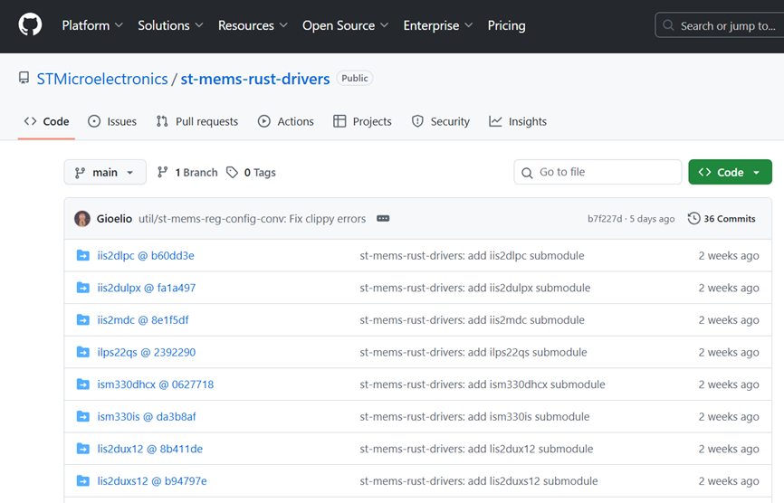

In a significant advancement to our software ecosystem for embedded sensor applications, ST has established a GitHub repository with platform-independent Rust drivers for MEMS sensors. The repository, accessible at https://github.com/STMicroelectronics/st-mems-rust-drivers, offers a comprehensive collection of Rust libraries designed to facilitate and expedite the integration of ST MEMS sensors across a broad spectrum of embedded platforms.

We have developed a suite of platform-independent Rust drivers that deliver robust, efficient, and user-friendly interfaces for a wide range of MEMS sensors. The repository contains dedicated Rust driver submodules for each sensor, standalone example projects, comprehensive integration guidelines, and auxiliary utility tools.
The following Nucleo expansion boards and sensors are already supported:
  • X-NUCLEO-IKS4A1: LSM6DSO16IS, LIS2MDL, LIS2DUXS12, LPS22DF, STTS22H, LSM6DSV16X
  • X-NUCLEO-IKS5A1: ISM6HG256X, ISM330IS, IIS2DULPX, ILPS22QS, IIS2MDC
  • Additional sensors: LSM6DSV320X, LSM6DSV80X, LPS22HH, LIS2DUX12, ISM330DHCX, IIS2DLPC

Developers interested in exploring the newly released Rust drivers should visit the GitHub repository at https://github.com/STMicroelectronics/st-mems-rust-drivers. The repository contains detailed documentation, setup instructions, and example projects to facilitate rapid onboarding.
