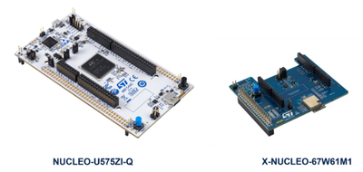

 1. Main processor board:the NUCLEO-U575ZI-Qwith the STM32U575ZI MCU, an Arm® Cortex®-M33 with TrustZone®, 2 MB of flash, 786 KB of RAM, provides ample resources to run the Matter stack and your application. The STM32 ecosystem allows for easy porting to other STM32 MCUs.
 2. Connectivity expansion board:the X-NUCLEO-67W61M1 with ST67W611M1 module, acts as a dedicated network co-processor managing Wi-Fi 6 and Bluetooth® LE concurrently.
This architecture ensures that your MCU is relieved from the complexities of wireless stack management, resulting in a more responsive application and improved security through clear separation of concerns.
