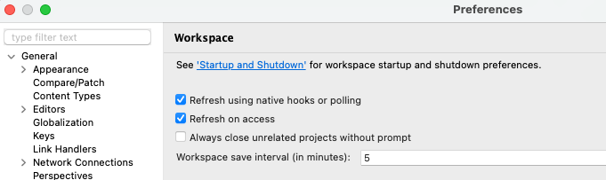

Auto-refresh of Project Explorer
The Project Explorer now automatically updates when files in the workspace change.
This removes the need to manually refresh after code regeneration (for example with standalone STM32CubeMX), improving interoperability and saving development time.

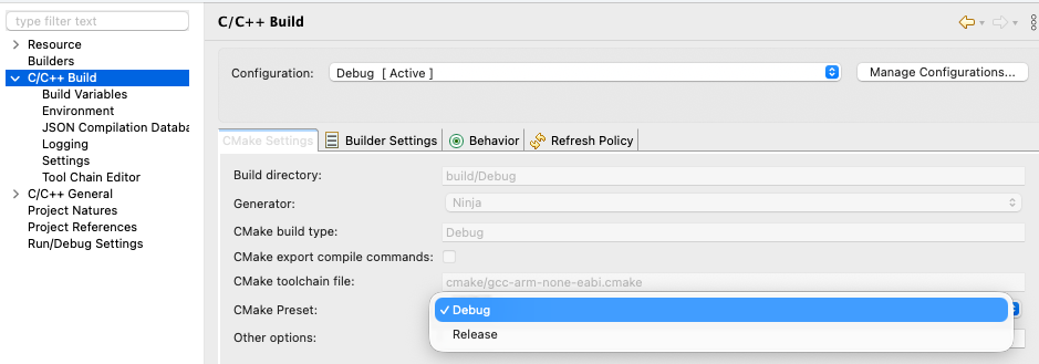

CMake presets support
STM32CubeIDE now supports CMake presets, the modern interface between IDEs or CI systems and build systems.
This makes it easier to import existing CMake-based codebases into STM32CubeIDE, streamline CI integration, and work smoothly with STM32CubeMX2 exports that use CMake instead of native project files.

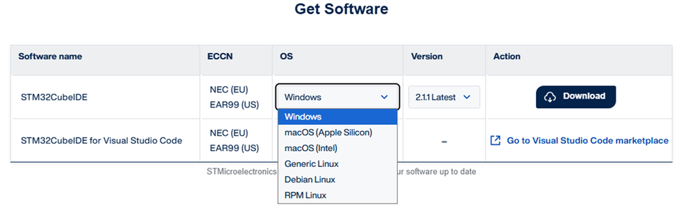

Native macOS AArch64 support
A new all-in-one macOS installer provides AArch64 binaries for JRE, GCC, and key utilities.
Mac users on Apple silicon benefit from noticeably faster builds and smoother overall performance, with remaining x86_64 tools to be migrated in future updates.
