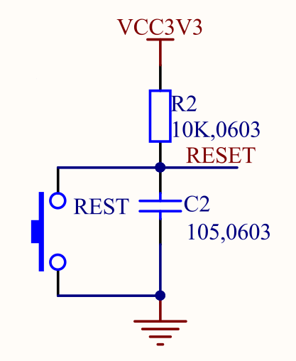

The Buttons i implemented are on NRST/BOOT0 and on two GPIO outputs. Do i actually need to Boot Button because now im using JTAG/SWD instead of DFU, where i need to start in Boot mode?
Did i use the right Pull Down resistors on the Buttons?

Your pulldown on reset/boot is useless because when the button is open, it is connected to nothing.
You can use something like this:
0693W000005BfBHQA0.pngPlace the Capacitors on the Supply Voltage right next to the VDD Pins (always next the consumer for small capacitors)
wrong. There is an internal pull-up, see "Figure 4. Reset" circuit in der app note mentioned above.
If you mean the TY_BOOT and TY_RESET Button, they are connected to a other device to perform a reset/boot on this device not on the stm. I realized the reset Button on the NRST pin like on the reference schematic.
