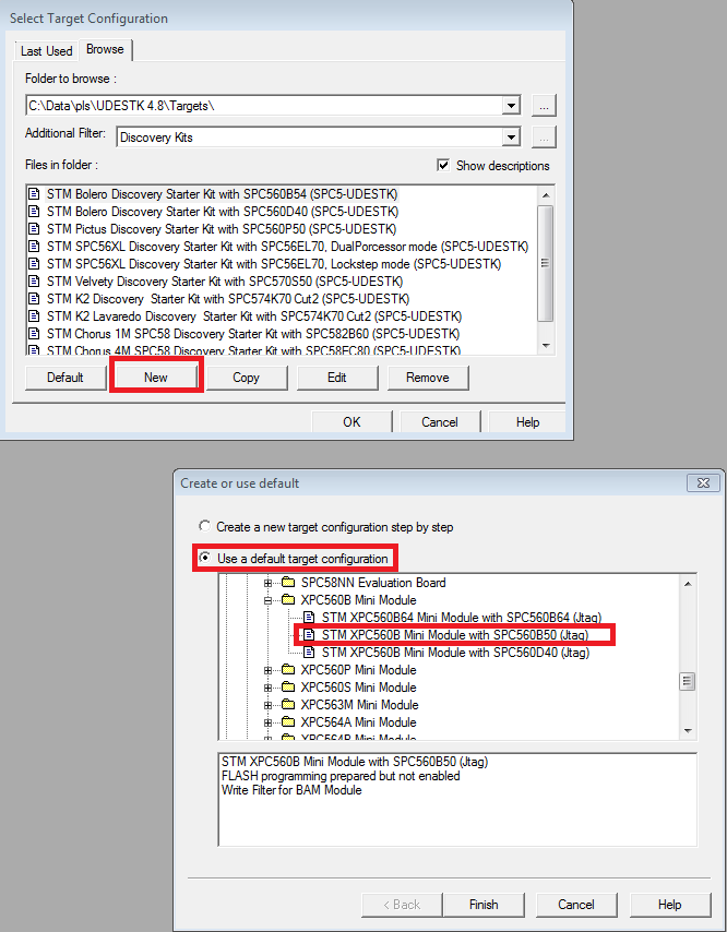

I am using a SPC560C50L3 controller on a SPC560BADPT100S MINIMODULE board which sits on the XPC56XX EVB Motherboard. Power supply checked, jtag driver checked. The JTAG used is from PLS USB/JTAG Adapter for SPC5XXX.
Using a sample application (CAN application), I could manage to build the code. But from here on, I tried to read the manual to use the JTAG debugger but I could not successfully flash code. Another thing I notice while using UDE STK4.8 version, is the Target names (in Select target configuration) DO NOT match any of the names (name of controller, minimodule or the motherboard). From this what I understand is I do not have a target configuration file, specific to the board in use.
How can I solve this?? Any help is appreciated. #spc5 #pls #spc5-studio #jtagSolved! Go to Solution.

Hello Raghu ,
Sorry for the late answer,
in PLS UDE tool 4.8, you should create your workspace from scratch
(cf Screenshot)
Best regards
Erwan
