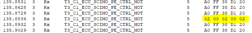

I am facing an issue wherein the CAN transmit message is sending wrong data for one sample in between the transmission. Please see the below screenshot.
0693W00000NsdjFQAR.pngT3_C1_ECU_SCIMO_PE_CTRL_MOT is a transmit frame with a cycle time of 10ms.
The transmission baudrate is 1Mbps.
As highlighted in the screenshot, the transmit message is sending garbage wrong values for 1 cycle and returns to the original value assigned from the applicaiton software.
Microcontroller platform = SPC584xx
Development toolcahin = SPC5Studio 6.0.0
Low Level Drivers = Generated by SPC5Studio
RTOS used = FreeRTOS
Please can anyone help me to understand where the issue is?

Hello ,
I think that a deep debug is needed.
Have you checked or enabled ECR register (Transmit Error Counter or CEL)?
Do use Threads in FreeRTOS ?

Hi Erwan,
Thanks for the response.
I am not sure about ECR register.
I am using multiple Tasks of different time periods (10ms, 50ms, 100ms, 200ms and 1000ms) using FreeRTOS.
Please find attached the configuration.xml file that I am using with the application.
