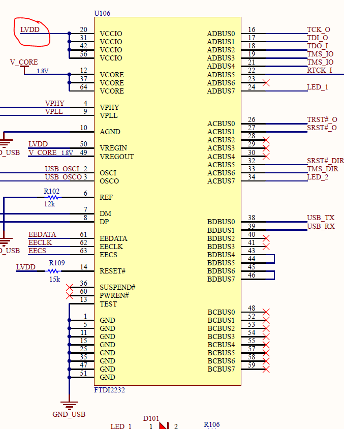

Yes, the third board also stopped working after few hours.
Now I've got one question:

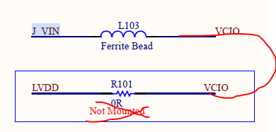

According to the board's schematics, the FTDI2232 is connected to 5V:
According to the Data sheet of the FT2232 , its absolute maximum rating is ~3.6V.
Especially for VPhy it's written " Note that this cannot be connected directly to the USB supply. A +3.3V regulator must be used. "

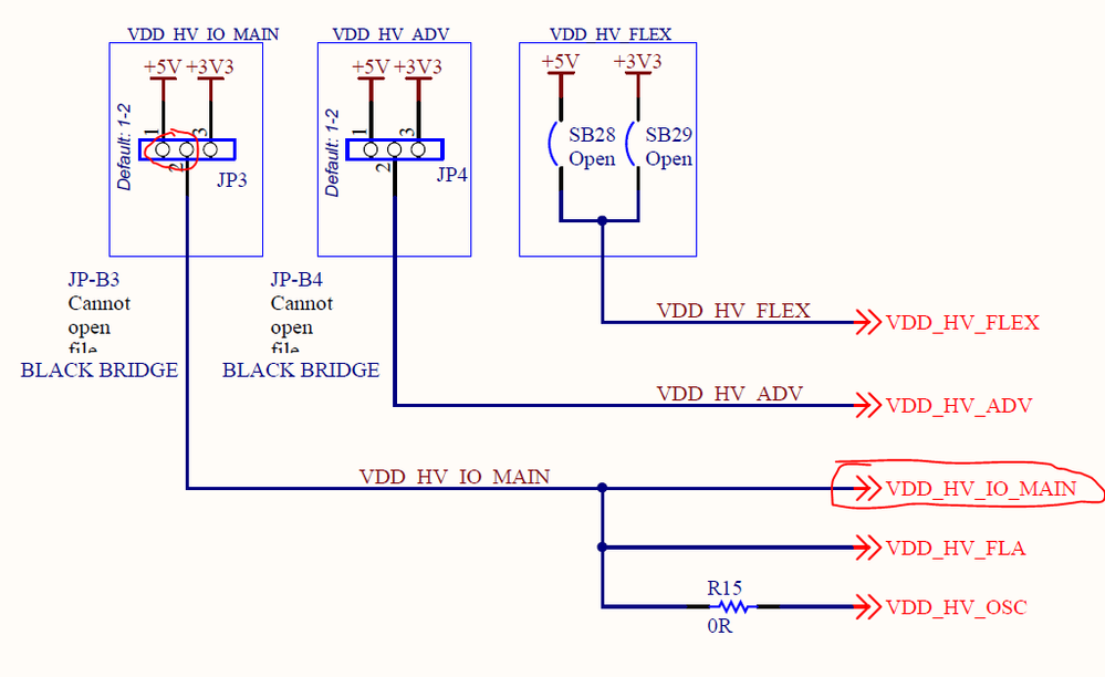

Mounting the jumpers JP3 back to its initial position rises the voltage from 3.3V to 5V at TP100 (LVDD). Unfortunately I have no board left now to test whether this is the cause of the problem...
