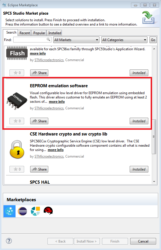

Erwan YVIN
Posted on December 06, 2017 at 09:44
Hello Daniel ,
Did you try EEPROM Emulation Software coming from SPC5Studio Marketplace ?
There are some examples in Application repository example.
    Best regards
            Erwan
Posted on January 08, 2018 at 11:11
Hello Erwan,
I was out of office for a while and found now your reply.
Thanks for your suggestion, sounds very good! Actually I didn't consider to check in market place for additional drivers, this seems to be what I was looking for.
Thanks a lot for your help.
