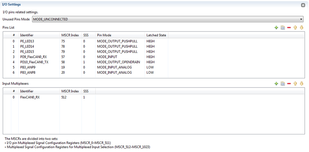

Modified Pin Settings:

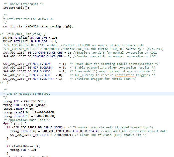

in main.c I tried to initialize and use the ADC:
Without ADC-code CAN example works fine.
But if I try to get Access to the ADC-regs, System crashes:

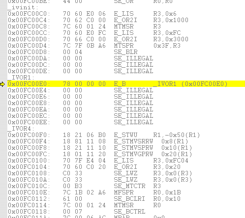

The system always stays at the _IVOR1 after SAR_ADC_12BIT_B0.xxxxx = x command.

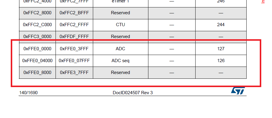

Sorry , i was on a bad revision of the reference manual not the last one (Revision 6 RM0349)
Table 12 was not correct on rev 3.

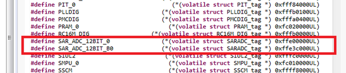

it seems to be a header file issue on SARADC Section & Documentation.
the address 0xFFE3c000 is RESERVED and IVOR1 logical according the RM.
Could you replace SAR_ADC_12BIT_B0 by SAR_ADC_12BIT_0 (cf xpc570s.h)?
Anyway , i am submitting an ER for this inconsistent header file.
