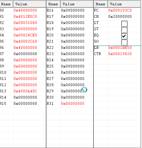

OK,
this is the CPU status, while the application is stuck.

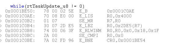

The link register contains address 0x0001BE50, which links to the following code:
I don't know if this information is useful..
To find what cuased the exception, shouldn't we be looking at what happened before the exception was raised?

Yes , Alessandro ,
The PC should be in unhandled exception
You should check just before the LR (a breakpoint before) ..
check the assembly command which triggers the assert
global variable and several registers.
is it an infinite loop ? or maybe corruption memory ?
there is big branch between 0x1BE50 to 0x1C0AE

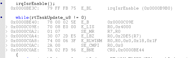

Posted on February 20, 2017 at 15:46
Hello Erwan,
thank you for your reply.
Please find below some further details.
I tried to put a breakpoint inside the unhandled_exception handler and then checl the ESR resgister content, and I got the following (VLEMI and ST flsg are set):
the content of the LR register was  0x000BE40, which points to the while statement.
The breakpoint just before indicates the instruction which might have caused the exception is the one at 0x000BE3C, which, as you can see from the mixed mode assembly screenshot, is the irqIsrEnable().
So I guess this is the cause of the exception.
Now the question is: why would the irqIsrEnable() cause such exception?
Is there any precondition that need to be met to run irqIsrEnable()?
