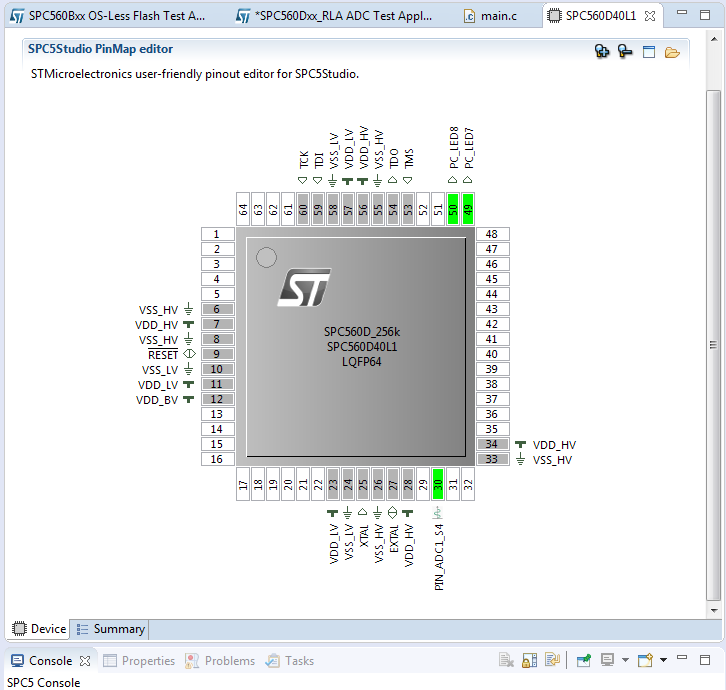

I am workin on SPC560P Discovery Board. I am trying to initialize the ADCperipheral using the components provided in the SPC5 Studio. What I am trying to do is to replicate the ADC Test Application in a different project. I initialize the ADC component in the project configuration andusing this in the main.c

Configuring the ADC I am using the same values provided in the ADC Test Application (channel: 10).
The problem is after loading the program on the board, that the ADC sample values are not updating, but remaining on a constant value. Removing the jp12 jumper is setting the sample value to 1, but changing the resistor has no effect on the sample value.

Hello Marcell ,
Warning : for Standard channel , we should PSAMP to 50
Have you configured correctly your pinmap Wizard ?
Did you arrive to End Of Conversion Interrupt ?

‎2017-07-14 2:36 AM
Thanks Erwan!
Somehow I forgot the Pinmap Wizard again, now it is works as expected.
