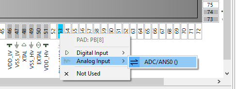

I want to use the PE7 pin of SPC560B to detect analog quantity
This requires reusing it as an ADC input pin
How should I configure him?
1 REPLY 1
ODOUV.1
PE[7] is not an analog input
You can use PB[8] for example in Pin map wizard:
