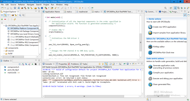

As shown in figure, I import a samples project, compile failure hint "make: * * * [components/spc560pxx_platform_component_rla/lib/RSC/rules. Mk: 164: elf] Error 1 "How do I solve it,T

SPC5Studio is using is own toolchain (gnu and gcc free vle)
You should enable the verbose mode and check your PATH.
You should check if com.st.tools.spc5.tools.gnu.gcc.ppcvle.win32_4.9.4.20200908161514\ is well installed
Have you got the same issue in the application coming from application wizard ?
Best Regards
Erwan
