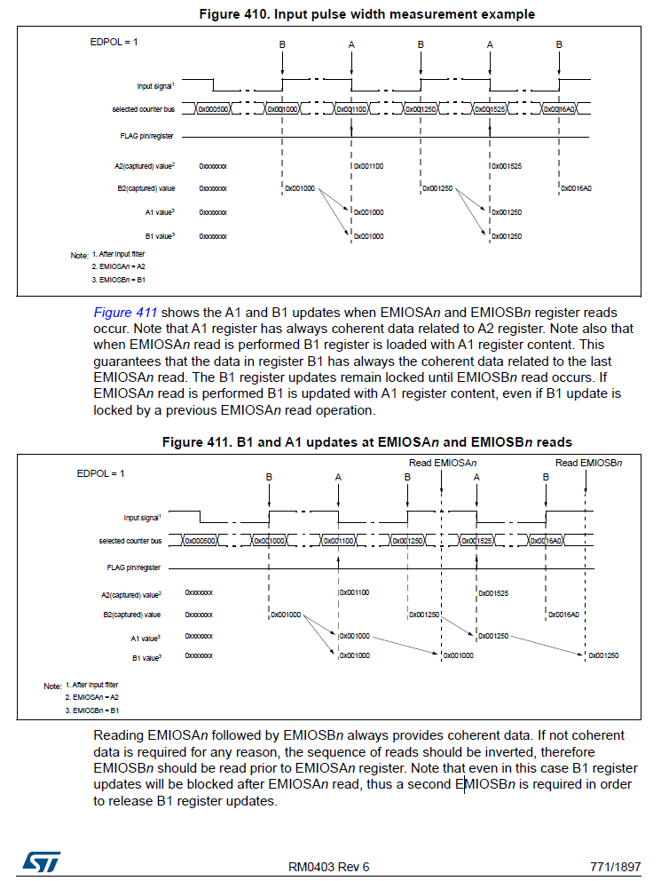

I tried to at least make the IPWM input work on eMIOS0 Ch 2 and created a little example project with channel 0 PWM output externally linked to the channel 2 input.
My new questions:
  • With eMIOS 0 global prescaler at 20, resulting in internal counter frequency of 1,000,000 (Hz?), the ICU prescaler at 1 gives 1,000,000 (Hz?), is there any way to increase ICU count speed by a factor of 10 to get decimal point of PWM "percentage"?
  • Is there any tool or table with recommended prescaler ratios between PWM and ICU?
In the attached patch.xml I reworked the icu_lld.c component implementation of the flag interrupt routine according to the reference manuals information.
0693W00000F9tWkQAJ.pngI setup the eMIOS channel with EMIOS_CCR_MODE_IPWM flag in icu_lld_start function.
Below you see the changed part of the icu_lld_serve_interrupt function:
if ((sr & EMIOSS_FLAG) != 0U) {
 icup->emiosp->CH[icup->emios_ch].S.R |= EMIOSS_FLAGC;
 if (icup->config->mode == ICU_INPUT_ACTIVE_HIGH) {
 	 if(icup->emiosp->CH[icup->emios_ch].C.R & EMIOS_CCR_MODE_IPWM && \
 			 (icup->config->width_cb != NULL)){
 		 icup->pe.a2_2 = (int16_t)icup->emiosp->CH[icup->emios_ch].A.R;
 		 icup->pe.a2_1 = (int16_t)icup->emiosp->CH[icup->emios_ch].B.R;
 		 width = (icup->pe.a2_2 - icup->pe.a2_1);
 		 icup->width = (uint16_t)(width);
 		 icup->config->width_cb(icup);
  • Substracting B1 from A2 as written on the page before gives me 50 (50% PWM) or 20 (20% PWM)
  • How to get 500 instead of 50 to have a little more resolution?
Maybe somebody had the same problems while getting IPWM to work. Hope my code helps a bit.

    Thank you very much for your analysis ,
    i am checking with experts.
    and i have created a Change request in order tol add IPWN configuration in our configuration.
    we will come back to you ;)
    Best Regards
