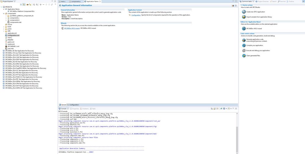

Here is a photo of my workspace.

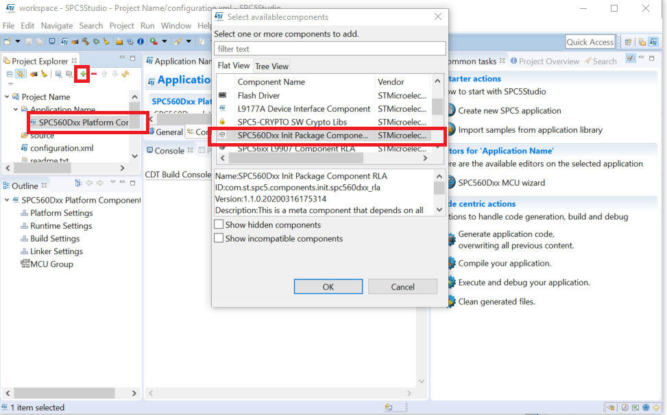

Hello ,
1) if you want to create a project from scratch
New-> New spc5 Project
a) Platform Component matching with your processor is necessary
2) After clicking the platform component, you can add some others compatible components
(Init Package is Meta Package which contains the minimum thing to boot.)
(cf screen shot)
It is possible to reimport Pinmap settings from others projects into your new one and vice-et-versa
Best regards
Erwan

2020-03-30 5:21 PM
Ah thankyou !!!
i couldnt figure out how to add those in
