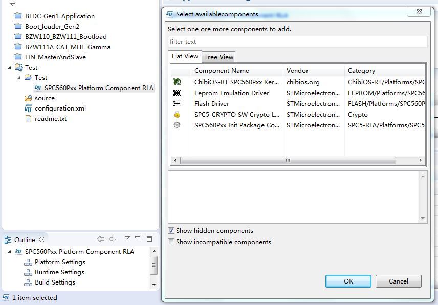

I need to update the SPC5 4.0 project to SPC5 5.6 project. But there is no SPC560Pxx IRQ component RLA in SPC5 5.6.

Hello Zhang ,
you have to choose the Init Package.
the Init Package is a meta component which Contains

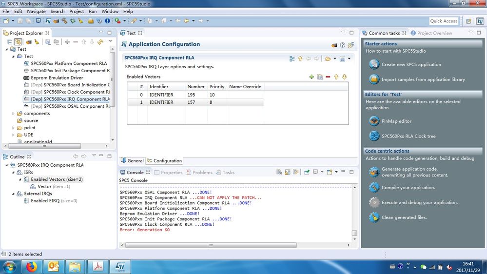

2017-11-28 06:20 PM
If I add the following two IRQ, there will be an error everytime. If I don't add the following two IRQ, there will be no error.
2017-11-29 12:54 AM
Hello Zhang ,
SPC5Studio has tried to apply the patch from your old application 4.0 'SPC560Pxx IRQ Component RLA' (not compliant anymore)
(cf Patch.xml)
You should remove your patch file or rename it before generating. (Example below)
from :
<?xml version='1.0' encoding='UTF-8'?>
<SPC5-Patch version='1.0.0'>
<!--It is your patch repository, do not break your XML File.-->
<files>
<file componentId='com.st.spc5.components.irq.spc560pxx_rla' version='1.1.0.qualifier' path='component/lib/src/eirq.c' user='false'>
<diff><![CDATA[--- components/spc560pxx_irq_component_rla/lib/src/eirq.c
+++ components/spc560pxx_irq_component_rla/lib/src/eirq.c
@@ -21,7 +21,7 @@
* @addtogroup EIRQ
+#define TOTO
#include 'eirq.h'
#include 'eirq_cfg.h'
#include 'osal.h']]></diff>
</file>
</files>
</SPC5-Patch>
into :
<files>
</files>
</SPC5-Patch>
Best regards
Erwan

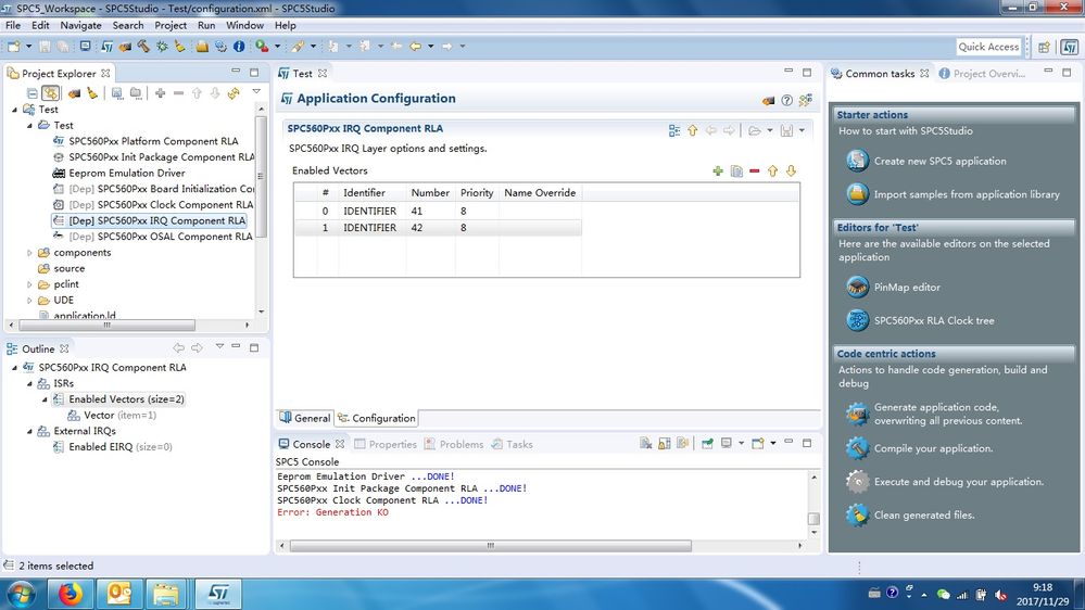

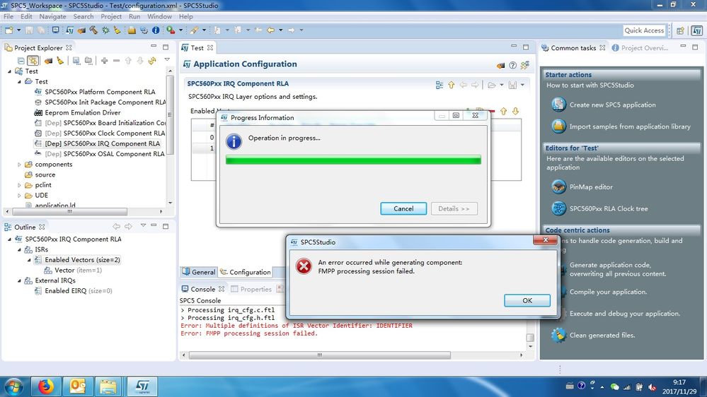

2017-11-29 01:30 AM
Hello Zhang ,
First , you have 2 exact identifier.Second , could you click on error Tab to check what is the error ?
c:\SPC5Studio\workspace\.metadata\.log
Best regards
Erwan
2017-11-29 01:43 AM
I changed the IRQ number and the error is still there.
