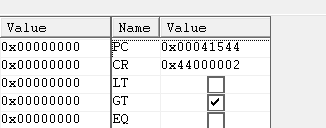

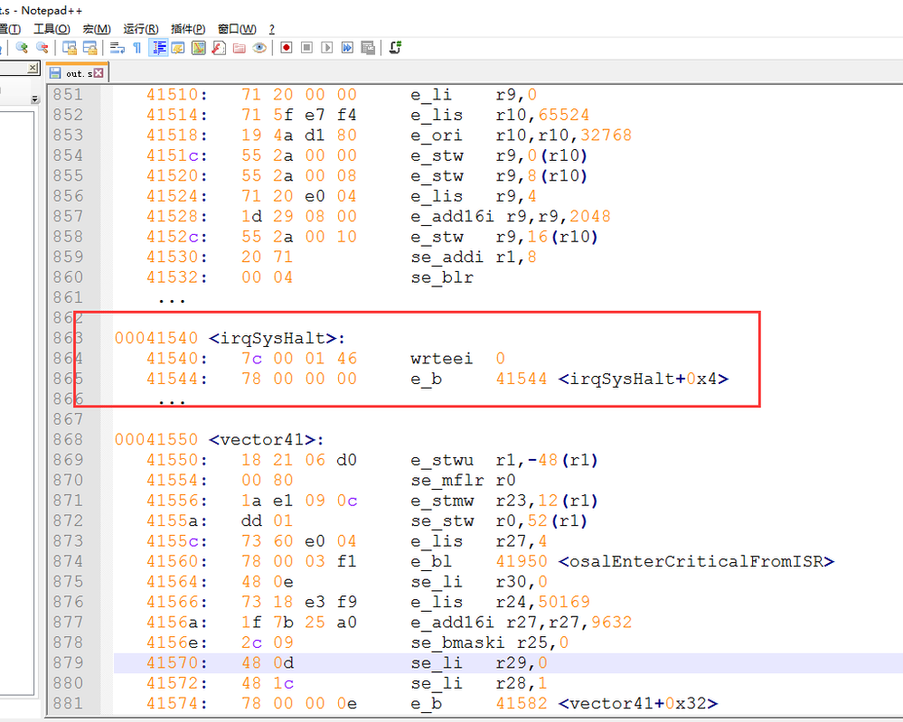

After jumping, it will enter the loop code?The value of the PC register is 0x00041544
So I entered the command at the terminal:
ppc-freevle-eabi-objdump.exe -S out.s
what should I do?

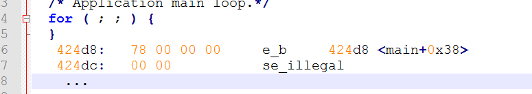

Through debugging, I found that my jump code must be changed to this:
// irqIsrDisable();
SPCSetRunMode(SPC5_RUNMODE_DRUN); (*(AppFunctionType)(JMP_ADDRESS+8))(); // jump to app and should not back
The value of the PC is 0x424d8
my APP code:
It looks like a success?
but could not execute the APP interrupt program..........

Hello Guo ,
(*(AppFunctionType)(JMP_ADDRESS+8))(); is valid because it is the boot sector structure.
The first 32 Bits contain the BootID
the next 32 Bits contain 32 Bits Reset Vector
(Cf RM0037)
Check your call stack, It seems to be a STATE Issue , check your registers just before switching states.
(cf figure 72 in the RM)
I think that you are going to SPC5_CLOCK_FAILURE_HOOK();

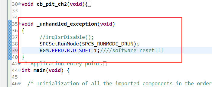

so I am going to modify the irqSysHalt function:
void irqSysHalt(void) {
irqIsrDisable();
SPCSetRunMode(SPC5_RUNMODE_DRUN); RGM.FERD.B.D_SOFT=1; //software reset ??? for ( ; ; ) { }}But the MCU did not restart...How to do it?

I should add ''soft reset'' to _unhandled_exception:
Before modify wrong..............................
