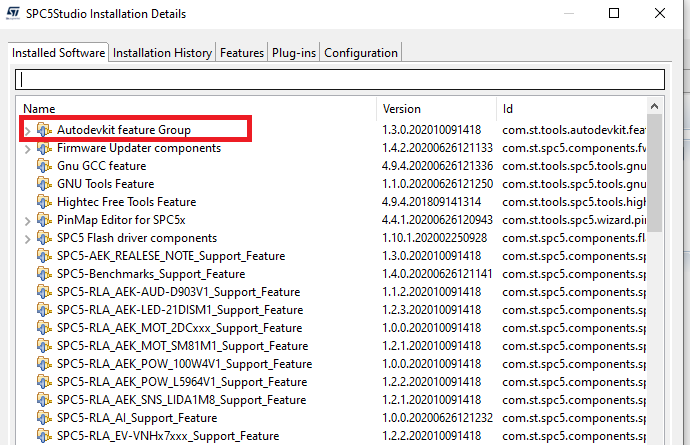

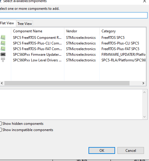

Hi i doing same as your doing download the Autokit plufin and install through the SPC5 studio 6.0.0 in that i selecting our controller which is SPC56P line in that i cannot able to add the component as Autokit please refer the images for refernce image1-> it is a component dialog box and image2-> is a installation list 0693W000005ABVyQAO.png0693W000005ABVoQAO.pngSo kindly help me if i need download any other plugins pls help as in this regard
Erwan YVIN
Hello ,
Autodevkit is not compatible with SPC56P
Best regards
Erwan
