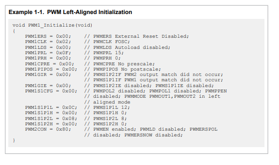

To configure the PWM module to generate a right-aligned output, the MODE bits of the PWM Configuration registers are used to select the output alignment mode and the P1 or P2 parameter registers are used to determine the resulting period of the output signal.
More you can learn at Pulse-Width Modulation (PWM) Tips and Tricks (microchip.com)

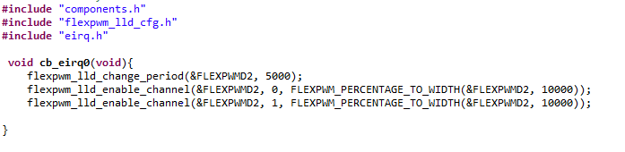

‎2022-09-06 7:43 PM
Sorry again, now my project is not looping. When i pressed the button, led only will ON on time, after that it will turn off permanently even i press the button, Here my c code
‎2022-09-07 2:46 AM
Hi.
I need to understand what yuo mean for reading push button duty cycle.
Have you a standard frequency?How much is it?
Because if frequency is low you can easy read digital input with pal library in polling every systick (1ms) then you can set your pwm.
Example:
