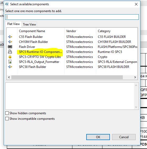

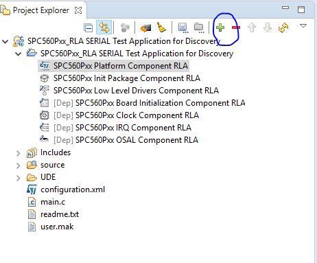

Please follows these steps
  1. Import a project using the wizzrd
  2. click on platform component and then on the + button in the upper right corner (see first image)
  3. select the runtimeIO component in the list of the components
Please let me know if it works.
