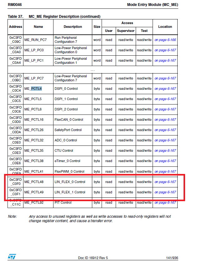

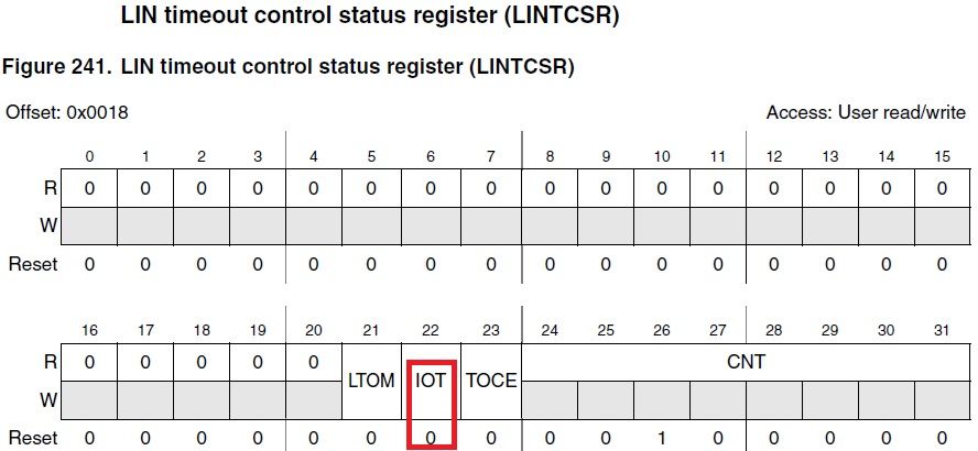

After MCU reset, I got the following and the IOT bit is set. But according to the RM0046(Reference manual, September 2013, Rev 5) the IOT bit should be reset after MCU reset.

    Hello Zhang ,
    Could you enable the associated PCTL ?
    and check again this register
      Best regards
