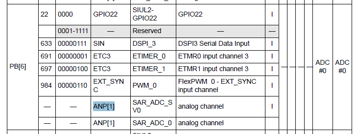

hello, may i know which code can i refer for ADC potentiometer ?

if i used the potentiometer on pin PI[1] and PI[2], which part in the code that explain about the pin number/ where i need to modified the code for pin number?

ion default example, the SARADC supervisor0 is used:
 /* change driverUnderTest value to test others SARADC modules. */
 driverUnderTest = &SARADC12DSV;
corresponding into low level driver component to this check box:
the channel used in channel 1:
uint8_t anp[NUMOFCHANNELS] = {1U};
in Reference Manual, it correspond to pin PB[6]:
you can verify it in the outline of the pinmap tool:
0693W00000QKGkEQAX.pngANP1 correspond to pin PB[6]
On your side, if you want to use for example PI[1] as analogue input, then use the pinmap tool to do so
and then you will have to enable channel5 ANP5 of ADC_12b_1
ODOUV.1
of course you will have to reconfigure the low level driver component to enable ADC_12b_1 and configure channel 5 of ADC_1 instead of channel1 of ADC_SV0 which is the default example
