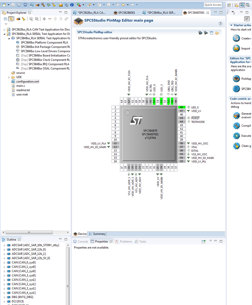

Hello... I am using SPC584B-DIS demo board evaluation for our project . I want to know each I/O pin configuration because I am using this board first i want to know each and every detail of that board. Can you please help me.

    Normally , there is a document which describes some Pinout of the board
    I am checking that.
    MCU )
    for the I/O Configuration, you can use the excel file attached in the RM
    The smartest way is to use the Pinma Wizard located in SPC5Studio
    It will generate your PIN Config by clicking on Save and generate
    Best Regards
