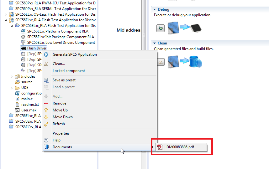

Hello Stefano ,
You can find some useful informations in the document (cf attachment) from the Flash Component.
Best regards
Erwan

Hi Erwan,
Thank you for the answer, I read the documentation and created an example application from SPC5 Studio wizard with FLASH drive
to understand how these API functions are called.
I still have a doubt: do I need to allocate them in ramcode ? Because in the example application I didn't see any reference to ramcode.
