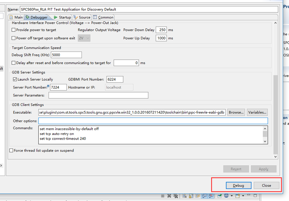

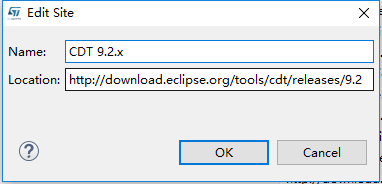

step 1:
install the  CDT 9.2

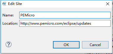

step 2:

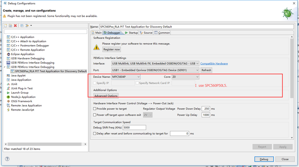

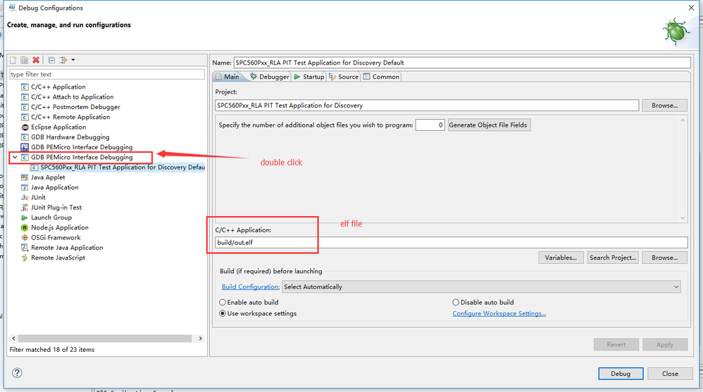

install the   pe micro interface debug plugin for eclipse

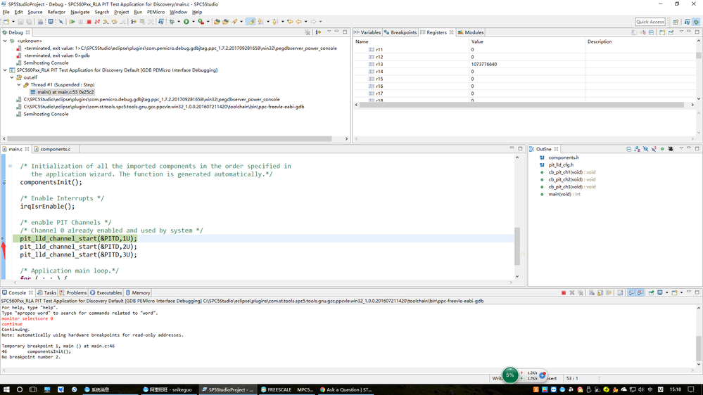

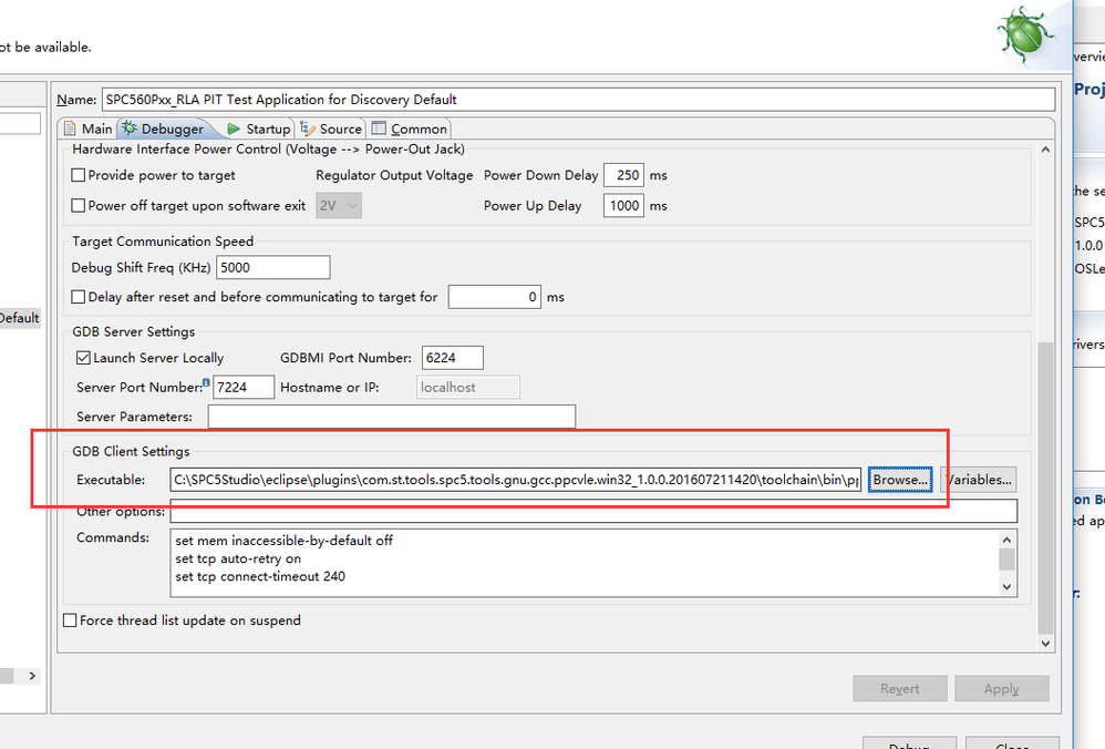

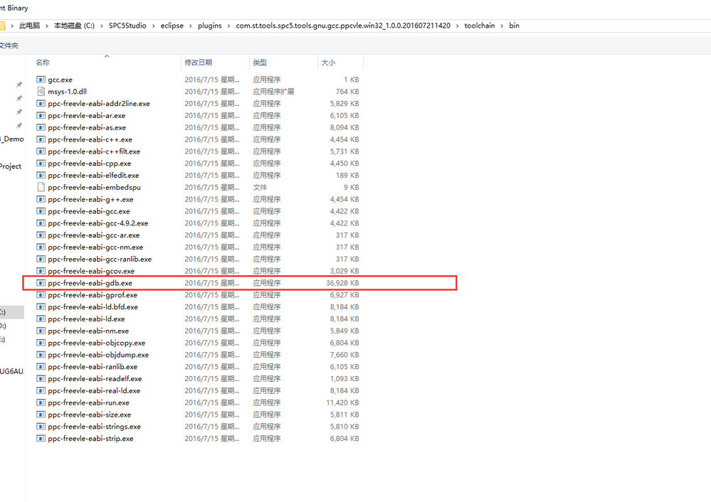

step 3:
select     ppc-freevle-eabi-gdb
click the debug button�
Running and debugging success!
