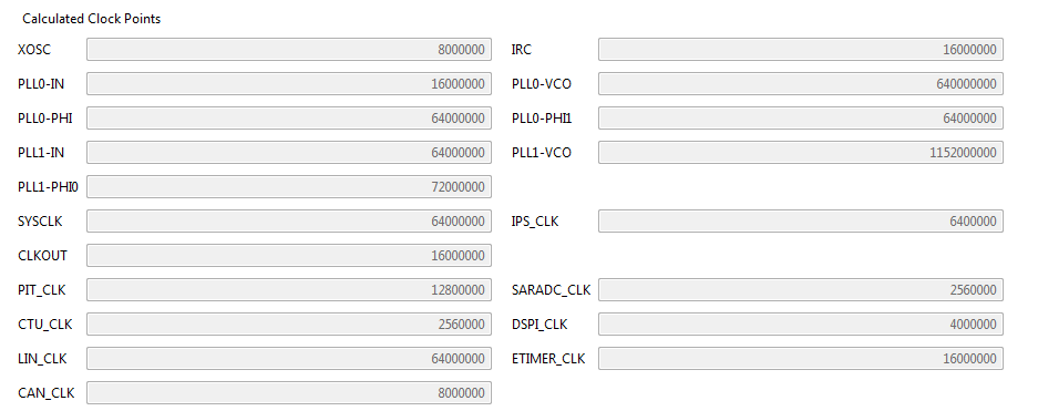

Hi, I amtrying to setup the clocks/PLL on the
SPC570S40E1 microcontroller.I would like use the PLL0 as the system clock.
Here is my configuration:
AC3 SC -> 16Mhz IRSOC
AC2 SC -> PLL1
PLL0 Settings:
PREDIV -> 2
MFD -> 80 RFDPHI -> 10 RFDPHI1 -> 10
PLL1 Settings:
MFD ->18 RFDPHI ->8
With the above settings, I get the following clkrates.
Here is my initialization code. Its getting stuck in the while loop waiting for PLL0 to lock. I am following the PLLs initializationprocedure that is recommended in the reference manual.

Posted on March 09, 2017 at 13:31
about your configuration, I suppose that you have set
AC2 SC  -> 16Mhz IRSOC
AC3 SC  -> PLL1
The opposite is not possible.
As described in the Reference Manual, any modification of the mode configuration register of the currently selected mode will not be taken into account immediately but on the next request to enter this mode (48.4.1 Mode Transition Request).
In other words, if you want to enable the PLL0 for the DRUN mode, you have to switches again to DRUN mode in order the modification takes into account.
So, you have to use the following isntructions
// Power up PLL0
MC_ME.DRUN_MC.B.PLL0ON = 1;
/* Switches again to DRUN mode (current mode) in order to update the
settings.*/
if (SPCSetRunMode(SPC5_RUNMODE_DRUN) == CLOCK_FAILED) {
SPC5_CLOCK_FAILURE_HOOK();
// Poll PLL0SR[LOCK] until it asserts
while (PLLDIG.PLL0SR.B.LOCK == 0)
In any case, let me underline that, if you want to change the mode configuration, you can use the graphic interface (section Module Entry of the Clock Component) by enabling the Advanced Mode.
Regards,
Luigi

sjpatel19922
Posted on March 09, 2017 at 16:49
Thanks Luigi, I was able to get it working. Unfortunately, SPC5 studio only seems to be working partially on my computer. I am able to work with the examples that were meant to run on development boards, but I cannot create a project from scratch as it does not show me the configuration options.
I have another question related to this.
What is the input clock source for the System Timer Module? In the datasheet, it mentions the 'System Clock', but it looks like the clock source is IPS_CLK
Thanks
Posted on March 10, 2017 at 08:30
about the STM clock, you are right. The counter of the STM is driven by the PBRIDGE (IPS) clock divided by an 8-bit prescale value (1 to 256). There is an error in the Reference Manual that will be correct in the next review. If you give a look to the SPC5Studio example named 'SPC570Sxx_RLA STM Test Application for Discovery', the IPS clock is set to 40MHz, the STM System Clock Prescaler is set to 40 and the counters of the 4 STM0 channels are set to 1000000, 2000000, 3000000 and 4000000. In this way the STM CH0 generates a interrupt after 1 sec, the CH1 after 2 sec, the CH3 after 3 sec and the CH4 after 4 sec.
