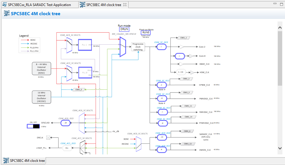

Hello community,
I just wanted to know whether you know of a clock tree wizard for SPC58xE.
I read in one post some years ago that there is no clock tree wizard for SPC58XE, but is there still none?
Is there any possibility to visualize the clock connections?
Kind regards
Tkorn
Erwan YVIN

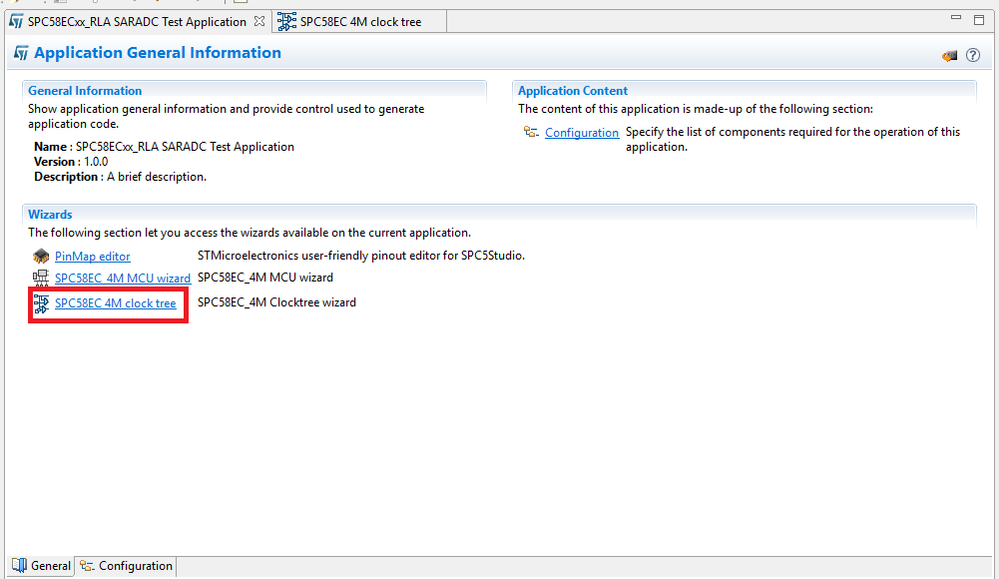

Hello ,
You can find a clocktree wizard in SPC5Studio 6.0.
It can generate source code based on your configuration
I recommend to check the application
SPC58ECxx_RLA SARADC Test Application for Discovery
                Best regards
                                     Erwan
2026-03-09 15_52_38-workspace - SPC58EC_4M Clocktree wizard - SPC5Studio.pngClocktree_SPC58EC.png
