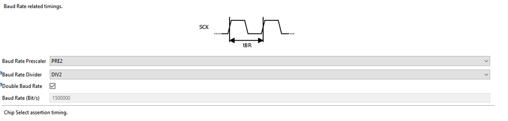

I am trying to configure SPI communication between L9963E and SPC574S64E3
I referred the DSPI example in the latest SPC5Studio
I could see the baud rate is configured to 1Mbps, 16kb and 26kb
But as per the L9963E Spec the baud rate is either 333kbps or 2.5Mbps
I tried with all the baud rate prescalars I could see more than 1.5Mbps
_legacyfs_online_stmicro_images_0693W00000bi3BwQAI.pngKIndly suggest, how to configure for L9963E chipset

Please check BMS example in latest AutoDevKit Studio www.st.com/autodevkitsw
