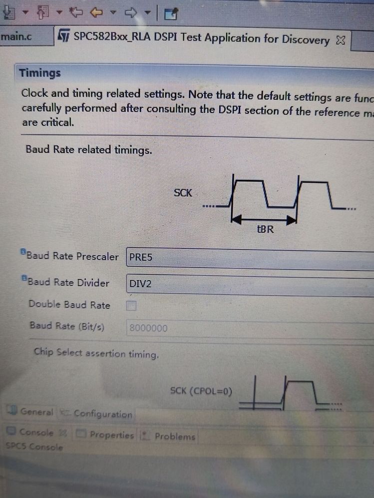

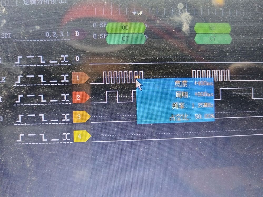

Hello everyone! I would like to ask about the DSPI baud rate setting for the SPC582BE1 microcontroller. As shown in the following figure, when using the SPC5828XX-RLA DSPI Test Application for Discovery routine, I found that the default setting for Baud Rate Prescaler is PRE5 and Baud Rate Divider is DIV2 The Baud Rate (Bit/s) is 8000000, and I used a logic analyzer to collect the SCK signal line of DSPI and found it to be 1.25MHz! I would like to ask how did this 1.25MHz come about? Can you tell me?

the test SPC582Bxx_RLA DSPI Test Application for Discovery configures three configurations:
  • high speed @8000000 bps
  • low speed @125000 bps
  • low_speed_16 @125000 bps

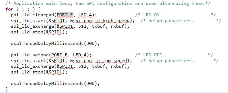

in the main loop, the first two configurations are used in alternate way.
So, I suspect you are capturing the second DSPI transaction which is at 125000 bps.
Here the code in the application main loop:

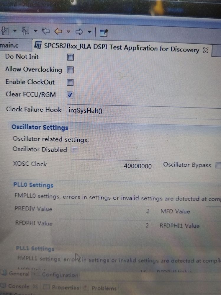

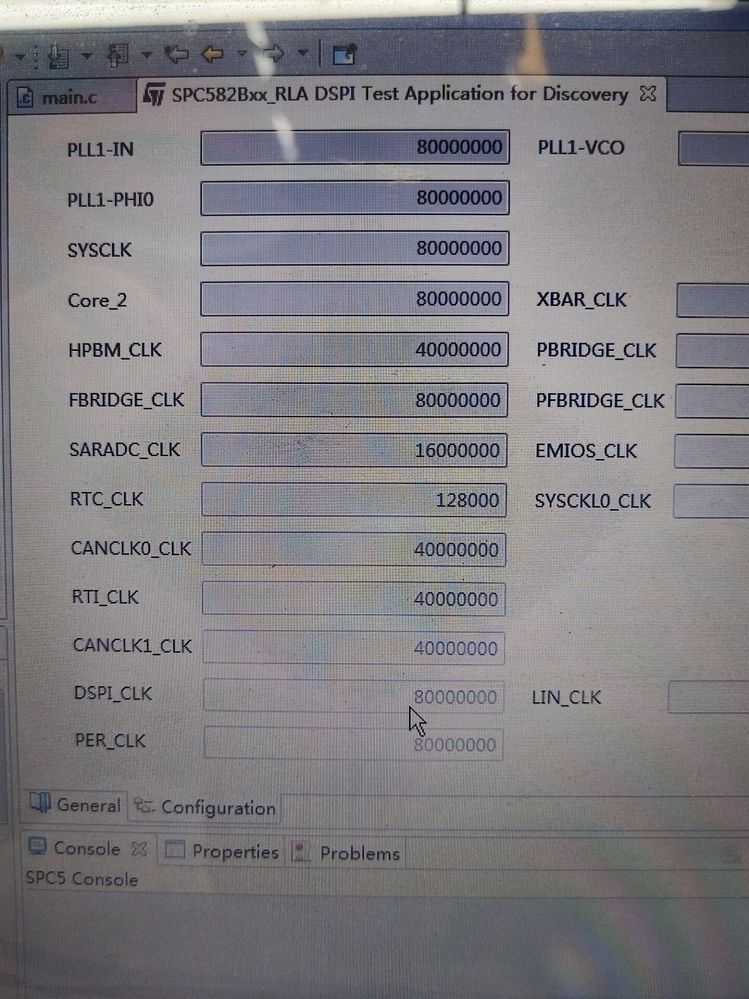

i dont know your cpu...but:
Obviously your clk setting is wrong.
You have 40M clk in ? But you have prediv 2 , so 20M ; and you set 80M as PLLin , but is 20M...set 20M here.
To check real clock, activate Clkout , check whats coming - and what it should be. Adjust your settings, until ok.

Just for info:
the formula to calculate the baud rate:
br = double_br * (DSPICLK0_CLK / (br_prescaler * br_divider));
where
  • double_br = 1 if double baud rate is NOT set
  • double_br = 2 if double baud rate is set
Best Regards
