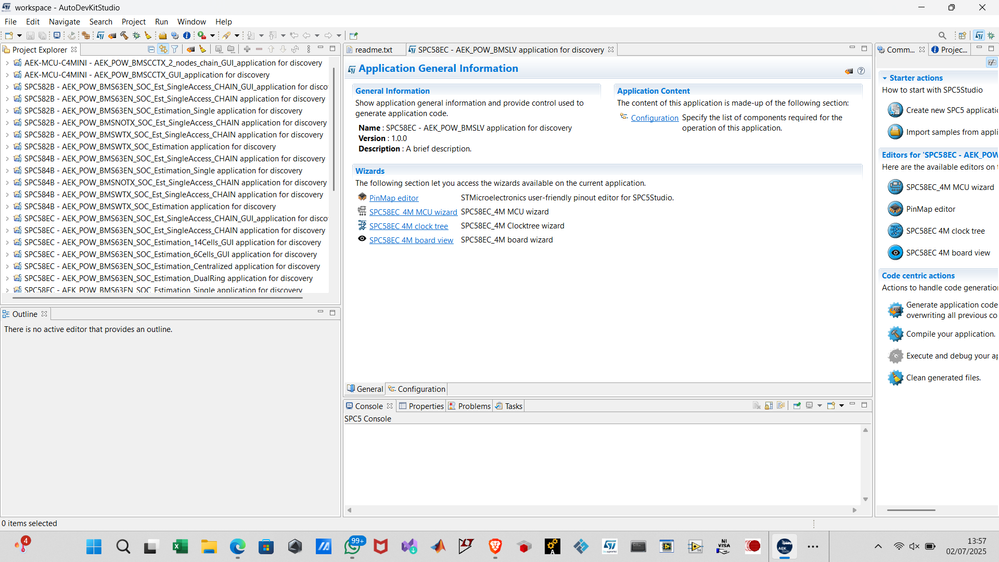

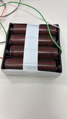

so in my case i use 4 cells and i have a battery holder different. it works or i have to buy your battery holder? I have this
which one of this demo i have to pick up for SOC/SOH on AEK-POW-BMSLV?
Cause the demo for this board hasn't this operation

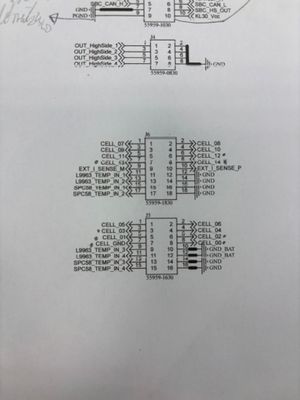

where i have to connect the positive of battery pack? cause the negative is J5 pin 7
No, our battery holder does not work with 4 cells, so keep yours. What is key is that you follow the correct IC wiring specified in the user manual on st.com or the system will not work.
I am not sure about your cell characteristics, if they are different from the one used in our model, the resulting SoC estimation might be poor.
The extended Kalman filter used for the calculation can be found in standard Matlab toolbox.
Our implementation can be extracted from Single_access_CHAIN_GUI demo.
Please understand that we cannot follow all single steps of a project in here. Community is for key points clarification not for step-by-step development consultancy.
Best Regards,
AutoDevKit Team
