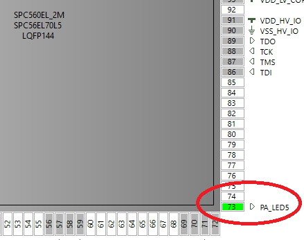

Dear Arash,
in your project :"SPC56ELxx_RLA DSPI Test Application for DiscoveryPlus"
you have a GPIO configured in OUPTUT to blink a LED:
_legacyfs_online_stmicro_images_0693W00000dDT4iQAG.pngit can be easily configured using the pinmap editor:
_legacyfs_online_stmicro_images_0693W00000dDT5HQAW.pngthen in your main function you have the code to call gpio driver to blink the LED:
  pal_lld_clearpad(PORT_A, PA_LED5);       /* LED ON.         */
  osalThreadDelayMilliseconds(300); /* WAIT 300 ms */
  pal_lld_setpad(PORT_A, PA_LED5);        /* LED OFF.        */
put you mouse pointer on the function pal_lld_setpad and do <CTRL>-left click to navigate in your code.
Best Regards,
-Olivier
