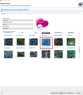

The avbove board comes with a blink example preloaded. I am looking for said example, any suggestions? The preinstalled suggestions seem to target more advanced programs

Hello Orbiter,
there is a nice example in S0C5Studio or AutodevKitStudio 2.1.0
   Best Regards
                      Erwan

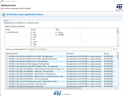

The problem is just that none of them is called "blink" or holds more info about what they are about than you can see in that view. I imported all of them and clicked thru. Its the RTC example that has the otherwise known as "Blink" example.
