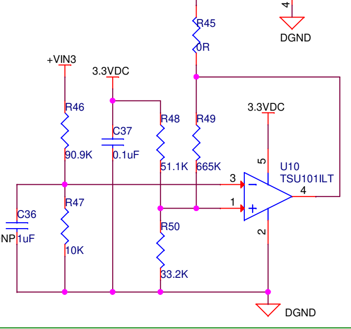

Hi All,
I have used ​TSU101 op. amp.as a comparator in my design. Output of opamp is used to drive relay through mosfet. My problem is when i connect power supply to my board o/p of comparator change for fraction of second and again work correctly as per design. My question is why op. amp switch it's states initially when powered up.
Thank You.​

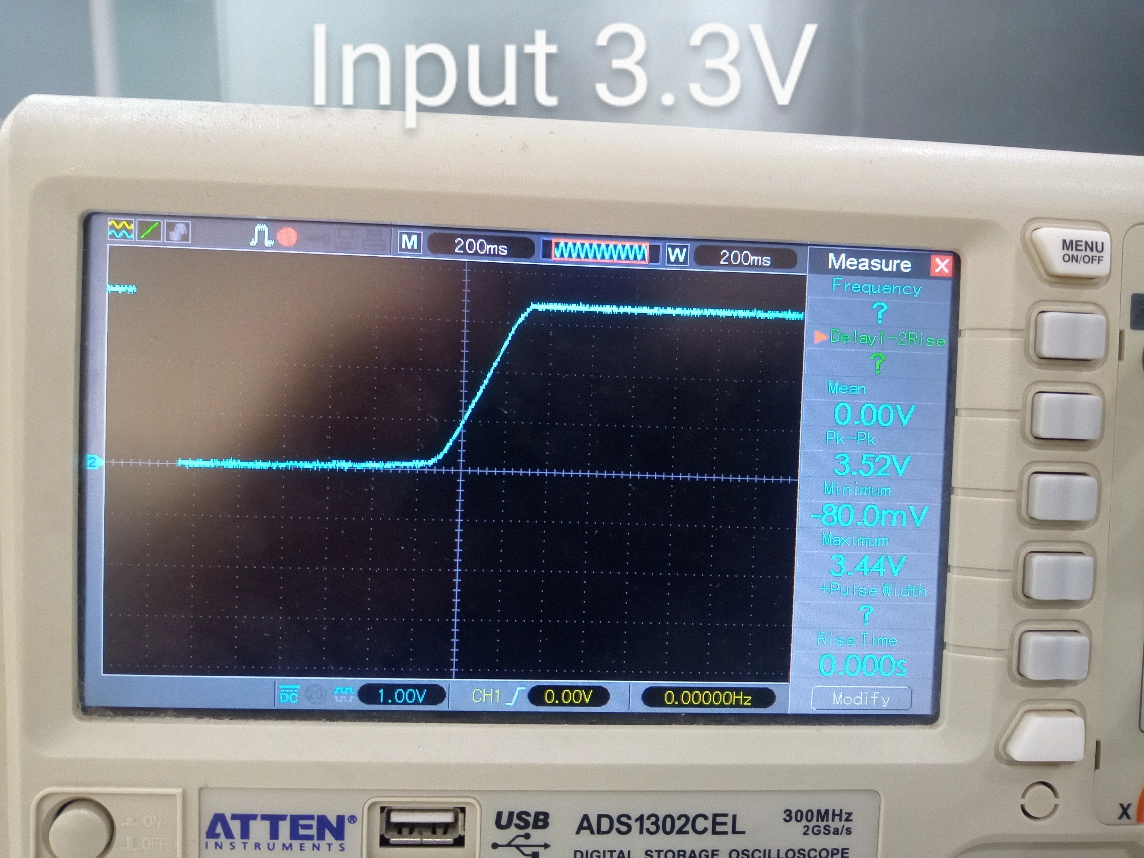

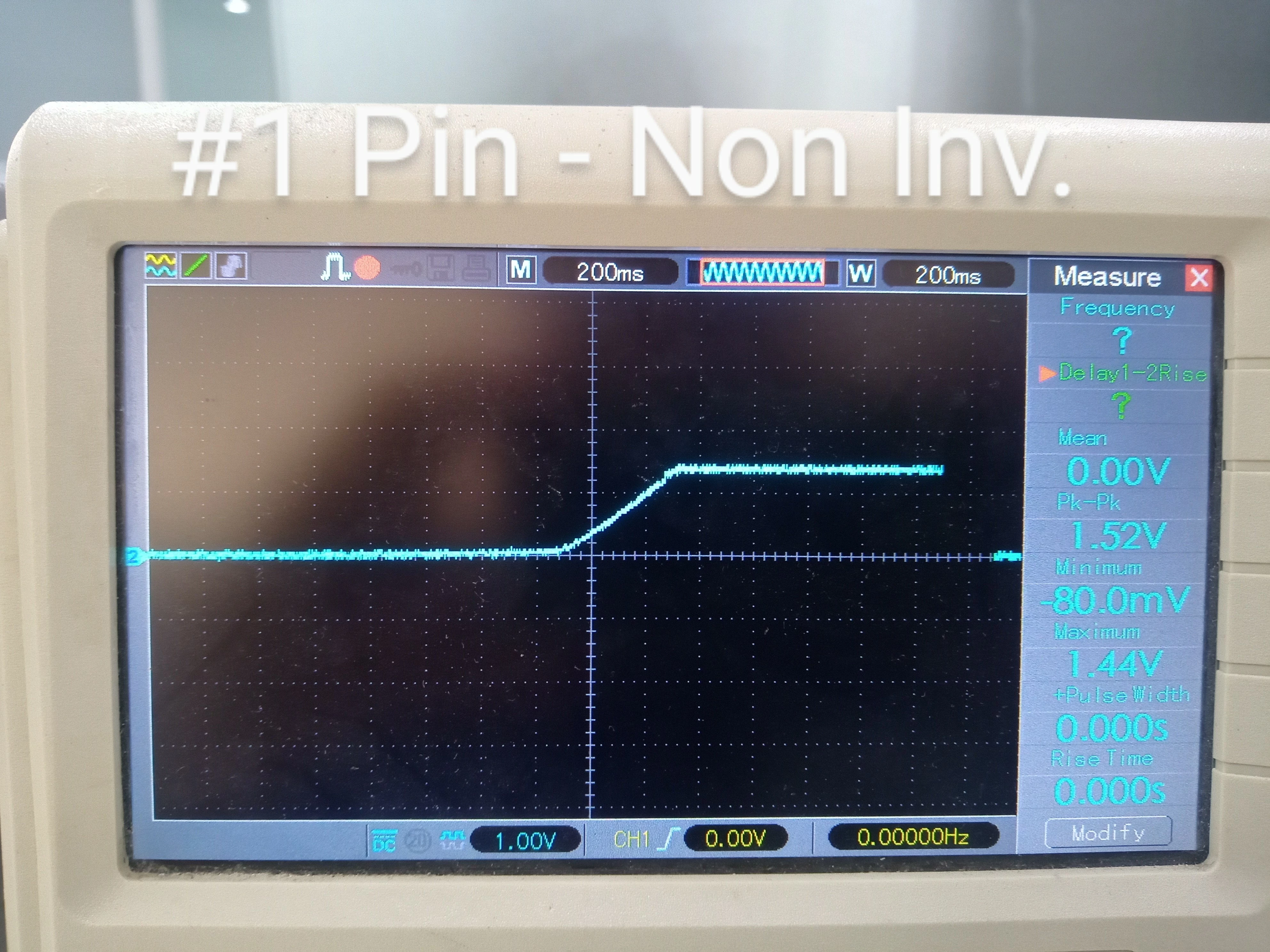

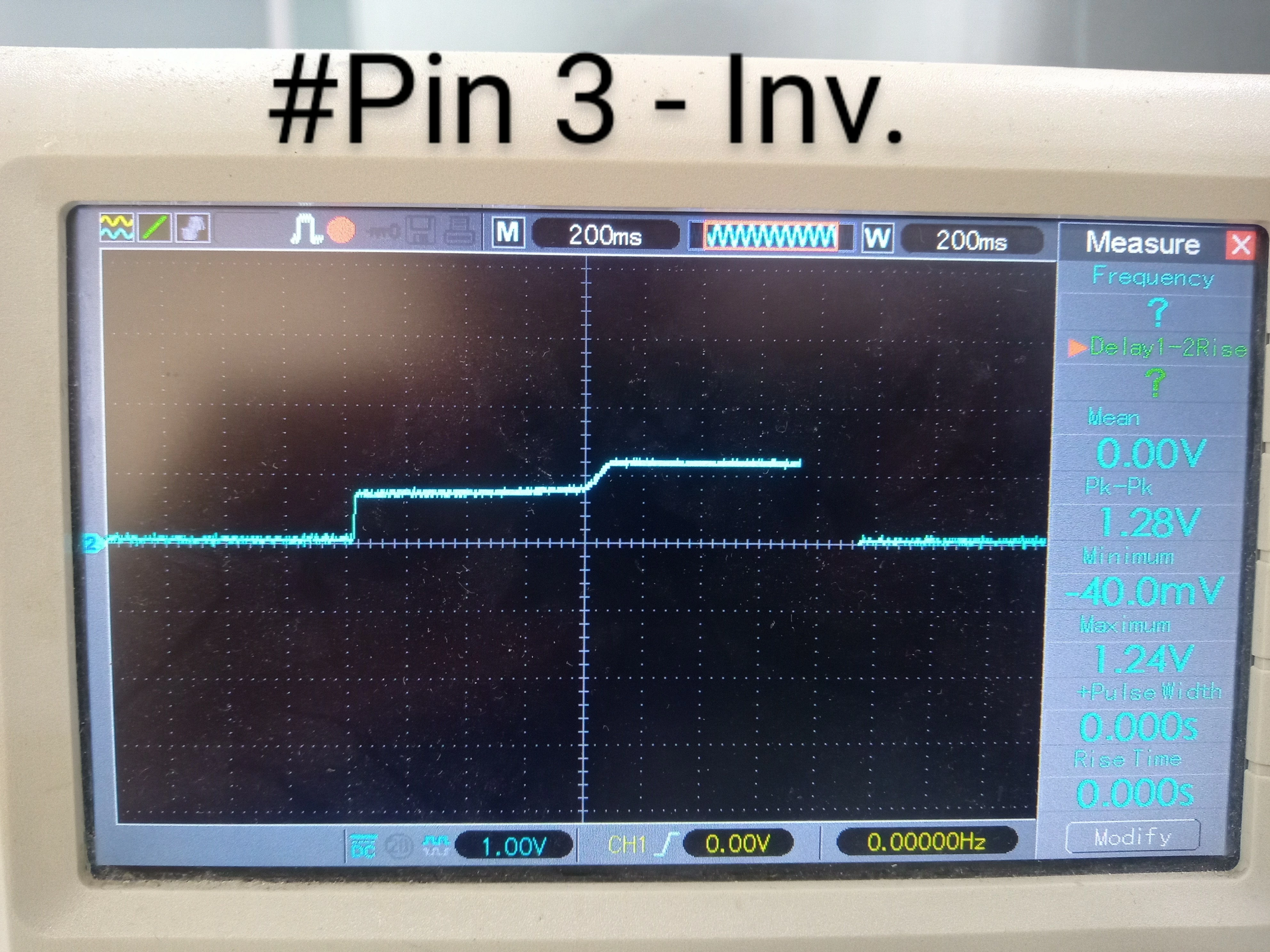

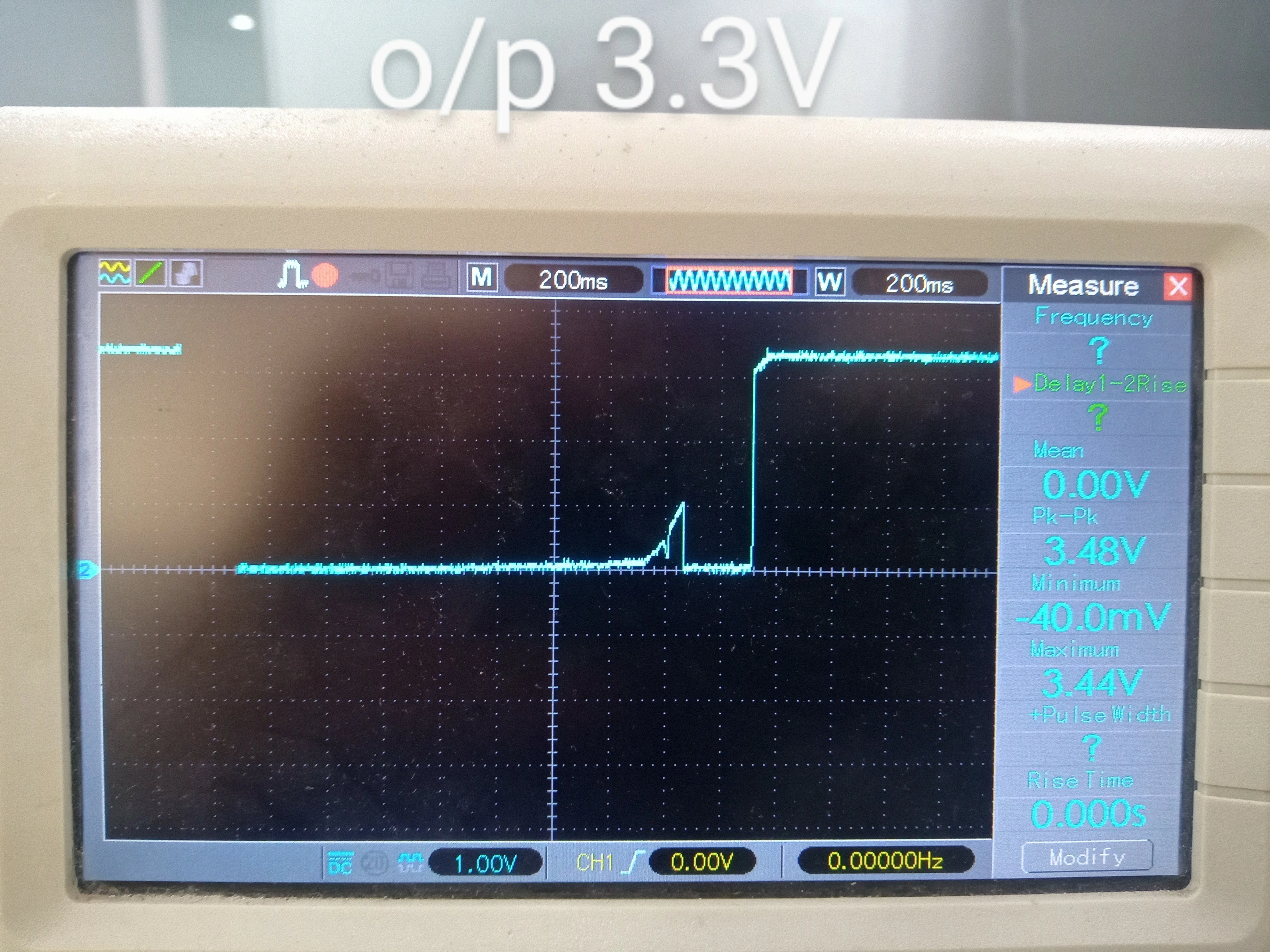

    I have captured all the waveform you have mentioned.
    0693W00000WLbpzQAD.jpg0693W00000WLbnfQAD.jpg0693W00000WLbrgQAD.jpg0693W00000WLbqiQAD.jpgThere is small change in o/p when power-up you can observe it. Output switch to 0V for around 200ms. We are not getting why this is happening.
    Pl. see the circuit: 0693W00000WLbuBQAT.png here, +VIN3 = 12V.
    What can be done for the solution? & why it is happening?

    At the beginning (below ~1V), the output is high and follows the power supply which is below the guaranteed minimum operating range.
    Then the output is low because the voltage on the non inverting pin is lower than the reference voltage on the inverting pin.
    During that period of time, IN+=0.38x3.3VDC and IN-=1.19V (from the moment when the input ESD protection diode is not conducting).
    So, the output remains low until 3.3VDC=1.19/0.38=3.13V, which is what you get in your waveform.
    It means that the observed behavior is normal.
