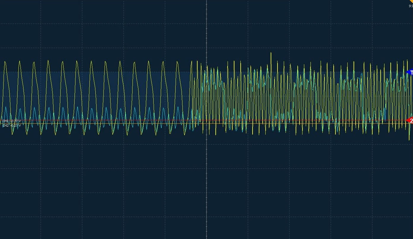

So here are my newest measurements, LRCLK (BLUE) and BCLK (YELLOW). The problem isn't jitter, but that LRCLK changes more often than every 32 BCLK, but only a few times per second.

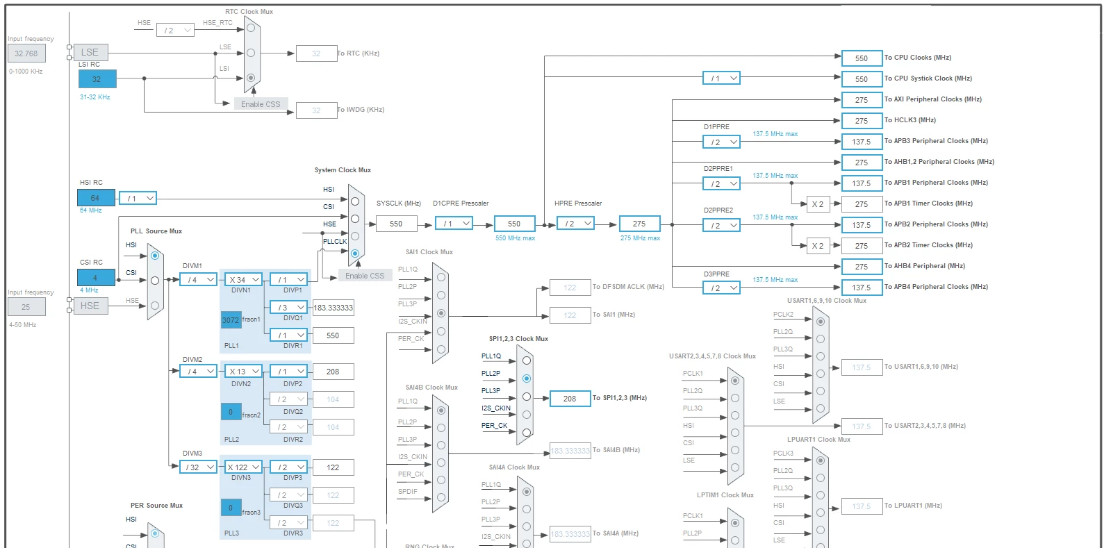

What's the primary I2S clock source?
Is that stable?
GkatsosAuthor
August 7, 2024
I am using the HSI -> PPL2P -> SPI1
GkatsosAuthorBest answer
August 8, 2024
So I have finally fixed the problem, my reluctancy to acknowledged using the HSI could be the problem has been my downfall.
I have tried adding 24.576 MHz to is2_ckin, and now everything is stable...
