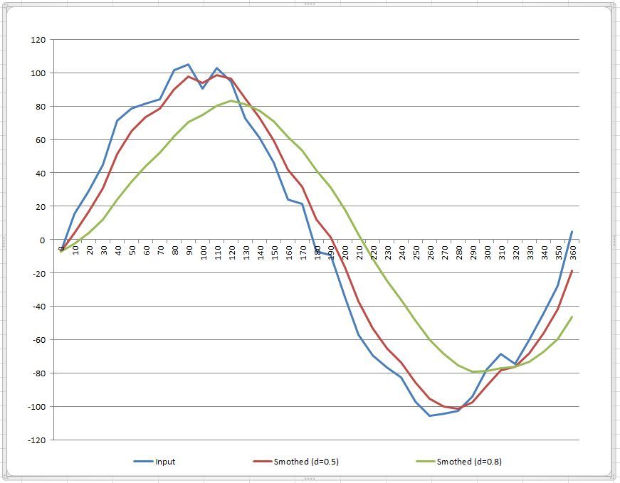

Here is an example:
The input signal is a Sine function with amplitude +- 100, added to that is random noise of +-10.
To filter out the noise we run the data through the filter equation first with d = 0.5 and then d = 0.8
 Code to reproduce the above >>

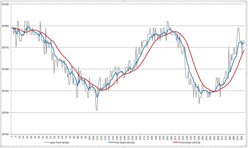

Here is a real world example:
Noisy pressure sensor – data; filtered with first order and third order filter, both with d=0.8
