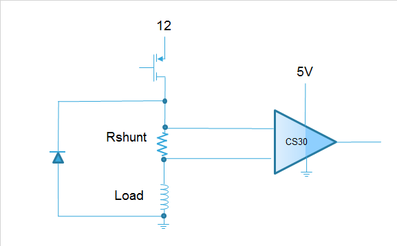

But if the current  flowing into the coil is regulate by a transistor like the picture described below, unfortunately the CS30 won't work anymore.
Effectively in the below case, when the Mos turns on, the diode is reversed biased off, and current flows through Rshunt to actuate the solenoid. If the Mos is turned off, the current in the Mos is interrupted, but the energy stored in the solenoid causes the diode to turn on and current to freewheel in the loop consisting of the diode, RShunt and the solenoid, and the input common mode voltage will fall down one diode below ground.
And unfortunately the operating Vicm range of the CS30 is from 2.8V to 30V.  The CS30 won't be damaged but won't be able to measure something if the Vicm is outside of 2.8V to 30V.

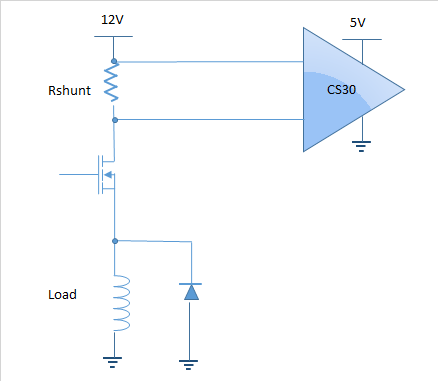

Your application is more clear, and the previous schematic shown the limitation of the CS30 use . And to bypass this limitation we can imagine to change a little bit the topology of the High side current sensing, like the schematic below:
In this case when the MOS is turned OFF the input common mode voltage of the CS30 remains 12V and works anytime.

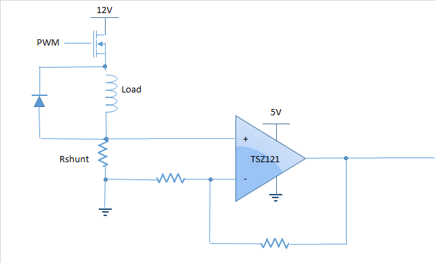

Or if it is possible, you can also choose a low side current sensing approach as described by the schematic below:
in this case a simple Opamp can be chosen, the TSZ121 is a good candidate as it is an extremely precise Opamp (Vio=8µV over temperature and Dvio/dt=30nV/°C).
The main draw back of this kind of architecture are .
  • you have to fix the gain with 2 resistors.
  • due to low side, a short cut of the load to gnd cannot be detected
  • when no current flown through the shunt the output of the opamp is saturated, and need almost 25µs to exist saturation when a current flow again into the shunt.

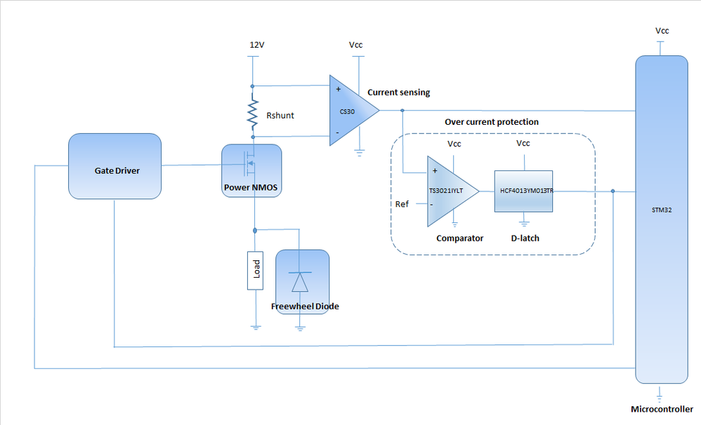

Just for information and maybe it cannot really match with your application, but in the past year I have experimented the following schematic.
The main goal of this application is to control the current into the load and switch off the system in case of over current event. The current measurement is extremely important, firstly to control the current flowing into the load and also to be able to take a decision in case of a default like a short circuit or over current event. This function is realized thanks to the high side current sensing CS30  which allow a precise measurement. The Power N-MOS is the key function in this application as it helps to control the current into the load and also serves to protect the application when default appears.
When a short circuit or over current occurs, the application must be switched off as quickly as possible. And moreover after such event, the application must not restart by itself and must stay switched off until a manual reload is applied. The TS3021Y is a high speed comparator, which combined with D flip-flop HCF4013, is used to realize a latch function in case of an over current event. As soon as an over current event occurs into the load, it takes less than 9µs to switch-off the power NMOS. The MCU generates a configurable PWM in order to drive the gate of the power NMOS by analyzing the data coming from the current sensor.
Hope it will help you in the design of your application
