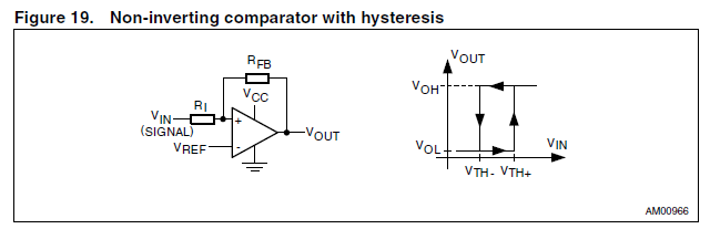

How works the internal hysteresis for comparators ?

Hi Jean,
The internal hysteresis is useful in order to suppress undesired output toggling. Moreover, it doesn't impact significantly the resolution of the comparator.
If the device doesn't include built-in hysteresis, or if a large hysteresis is required, a positive feedback network can be implemented as the following figure shows.
This figure shows that the high and low threshold voltages are different, thus a hysteresis configuration has been created.
It has been extracted from the application note
