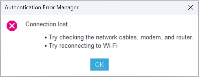

This is the first time I use STM32cubeIDE ver 1.15.1 . While using it, there are a few operations that need to be logged in. I already have an account in the practice room at school, but when I log in on my personal laptop, I see a box. "Authentication error manage" dialog as shown belowScreenshot 2024-05-14 171838.png
 meanwhile my internet connection is completely normal.

    After wasting almost a full day trying to fix the same issue you encountered, I went through the changelogs and saw that ST started forcing the log in in version 1.13.0 so I installed version 1.12.1 and that seems to work fine.
    It's annoying having to use an old version, but well... Hope they fix this soon.

    as said by @Ole1 :
    workaround: install CubeIDE 1.12.1
    It has no login functionnality and use latest packages.

    Hello @dnht
    The issue seems to be linked either to the server or the tool network connection settings.
    The possibility of having issue with the server is under investigation.
    If you are connected to the internet via a proxy, please follow the steps from the article bellow to set the tool correctly.
    How to set the network connection parameters for S... - STMicroelectronics Community

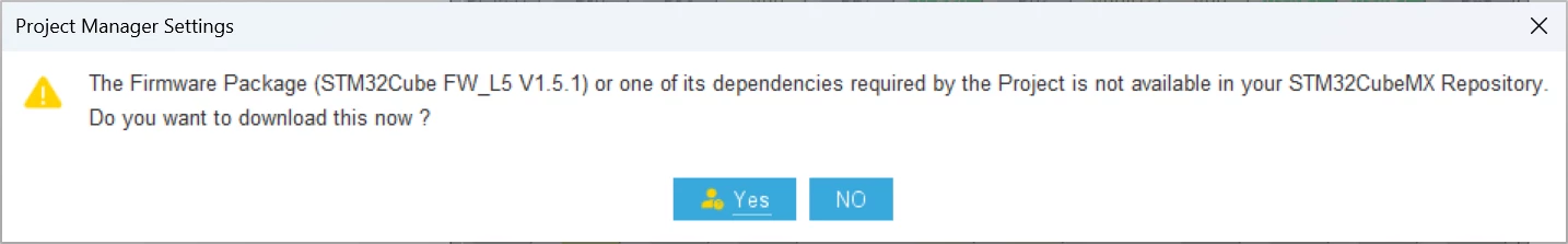

    I am having the same problem withe CubeIDE 1.17.0. I cannot connect to MyST via Check For Updates or Manage Embedded Packages. There are a number of similar posts about this error, but I have not yet seen a definitive fix. My IT guy and I have over 8 hours on this issue! I checked Network Settings and Checked Connection worked. I installed Chrome and made it my default browser. I downloaded STM32Cube_FW_H7_V1.12.0 manually and pointed to it in CubeIDE. Still can't login or generate code.

    I have the same problem:
    STM32CUBE IDE 1.16.0 @ win 7 64bit
    myST login - nothing happened
    Manage Embedded Software Packages - nothing happened
    firmware updater -> Check connection - OK
    From log:
    !MESSAGE Command 'com.st.stm32cube.ide.mcu.ide.command.userAuth.login' failed
    !STACK 0
    org.eclipse.core.commands.ExecutionException: Error executing 'com.st.stm32cube.ide.mcu.ide.command.userAuth.login': java.lang.NullPointerException: Cannot invoke "javax.swing.JComponent.setVisible(boolean)" because "this.webAppContainer" is null
    Can you help me? Not possible to continue with work :(

    I discovered a workaround by accident:
    1) Deleted the project I had created and opened in the IDE.
    2) Uninstalled the IDE.
    3) Opened the .ioc file using CubeMX, installed the correct FW drivers and generated code.
    4) Re-installed the IDE.
    5) Started a new project by opening/importing the .ioc file. I no longer needed to log into MyST to download the FW drivers.
    6) Was then able to compile and debug the code.
    Having the FW drivers installed prior to creating the IDE project seems to have been the important step.
