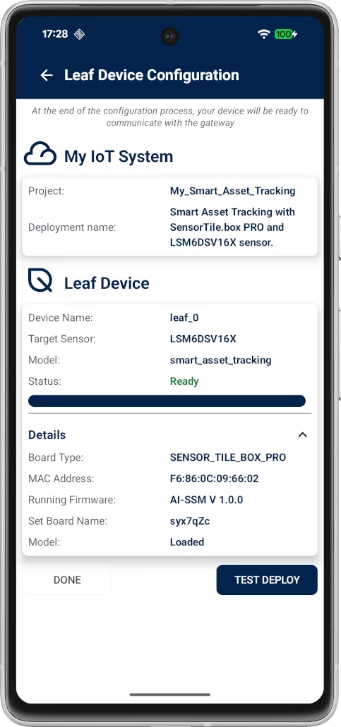

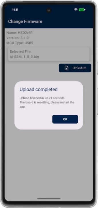

7.2 Setting up the leaf device with a mobile app
Flashing the board in case the selected connectivity is Bluetooth® LE can also be handled by the official ST AIoT Craft mobile app. It is available at the QR codes shown on the right side of the following panel:
Figure 14: ST AIoT Craft – Flashing the board can also be handled by the official ST AIoT Craft mobile app
Once you have the mobile app installed on your mobile device, open it (a) and scan the QR code of the project (b) shown on the left side of the webpage above.
(a) |
(b) |
The app shows the boards nearby (a), tap on your target device and start updating the firmware over-the-air (b).
(a) |
(b) |
The updating process initiates (a) and goes on (b) until completion (c).
(a) |
(b) |
(c) |
When done, your device reboots with the new firmware in Bluetooth® LE direct-connection mode signaling that it is waiting for connection by means of a blue LED always on. Tap on the board to let the app connect to it (a) and start configuring it (b) by setting its advertised name (syx7qZc in this case) (c) and uploading the MLC model available in the project (d).
(a) |
(b) |
(c) |
(d) |
The 7-characters name is advertised along with inference data, so that the mobile app and the gateway recognize the sender device. You can now validate the model on the mobile app.

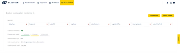

8. Complete the deployment
Press the All done, check the deployment status button to go ahead with the deployment of the IoT system.
During the first execution, the gateway configures itself and the sensor node. In particular, the gateway expands the file system partition on the microSD™ card to the available space and configures all required services. Moreover, the web portal sends a deployment manifest file to the gateway, to make it run the set of Docker modules required to handle the IoT system.
Figure 15: ST AIoT Craft – System configuration monitoring
This process may take several minutes, depending also on the speed of your Internet connection. Moreover, although the provided gateway image includes all the necessary edge modules, any new version must be downloaded from the official container registry, adding to the startup time.
Clicking on the Inspect gateway button opens a new tab in the browser that shows the modules running on the gateway in real time.
This view can be accessed by your host PC only if the gateway and the PC are connected to the same network, Multicast DNS (mDNS) is enabled, and the host OS allows it. For example, this might not be true behind a MITM proxy.
Figure 16: ST AIoT Craft Gateway Monitor – Docker modules
From this monitoring page, you can see modules’ log, restart modules, and reboot or shutdown the gateway at any time. For instance, the picture below shows the log of the edgeMLC main application module, from which you can get to know what is happening on the gateway.
Figure 17: The log of the edgeMLC main application module
