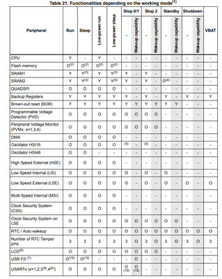

I don't care if this post breaks some sort of forum usage rule, I am really sick and tired of trying to get the same STOP2 values advertised in the STM32L4 datasheet. I’m starting to believe that these values are just ******* to attract customers, they have nothing to do with reality. I am expecting a range of 2uA, but my current is between 700 and 1000uA.

Hello @MikeLorden
Could you please provide more details regarding the peripherals used in STOP2? As you may know, some peripherals remain functional and can add to current consumption as shown in the image below (I2C3, LPUART1, LSE, or LSI …)

Hi
Peripherals used are: USART1, USART2, USART3, I2C3, QUADSPI

Hello again @MikeLorden
I2C3 is adding to the consumption, if not necessary, you may need to disable it. Regarding other peripherals, you can still enable them and set all their GPIO as analog, and the current should be as expected. To do so, add this code, between /* USER CODE BEGIN 2 */ and /* USER CODE END 2
__HAL_RCC_GPIOA_CLK_ENABLE();
__HAL_RCC_GPIOB_CLK_ENABLE();
__HAL_RCC_GPIOC_CLK_ENABLE();
__HAL_RCC_GPIOD_CLK_ENABLE();
GPIO_InitStruct.Mode = GPIO_MODE_ANALOG;
GPIO_InitStruct.Pull = GPIO_NOPULL; GPIO_InitStruct.Pin = GPIO_PIN_ALL; HAL_GPIO_Init(GPIOA, &GPIO_InitStruct); HAL_GPIO_Init(GPIOB, &GPIO_InitStruct); HAL_GPIO_Init(GPIOC, &GPIO_InitStruct); HAL_GPIO_Init(GPIOD, &GPIO_InitStruct); __HAL_RCC_GPIOA_CLK_DISABLE();
__HAL_RCC_GPIOB_CLK_DISABLE();
__HAL_RCC_GPIOC_CLK_DISABLE();
__HAL_RCC_GPIOD_CLK_DISABLE(); MX_GPIO_Init();
/* USER CODE END 2 */

2024-02-06 8:28 AM
I tried as you suggested and as expected it does bring the current down to 2.6uA. Thank you for your support.
