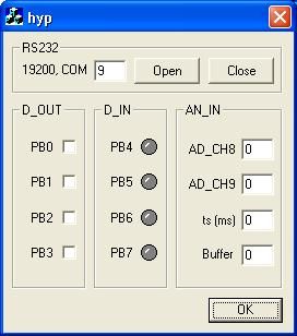

Dear friends,
I've implemented a sort of tiny PC datalogger via RS232 based on the Discovery board and an ST232 serial interface. It is only 2 ADC channels + 4 DIN + 4DOUT.
The sampling time is 15 ms but this is because of Windos Vista and not because of STM8 and communication (19200 baud is large enough).
To activate the DOUTs, I give a command to the STM8 which is 2 characters long: the first is a mnemonic like the char ''M'' followed by an unsigned int (u8) which is the output whic I want to activate.
The transmission from the PC application (VC++ 6.0) to Discovery is made char by char therefore I needed to manage the Discovery data reception using an IRQ handler which I'd like to attach in the following piece of code. Cut and paste it into the ''stm8s_it.c'' file.
It works fine.
Stefano
