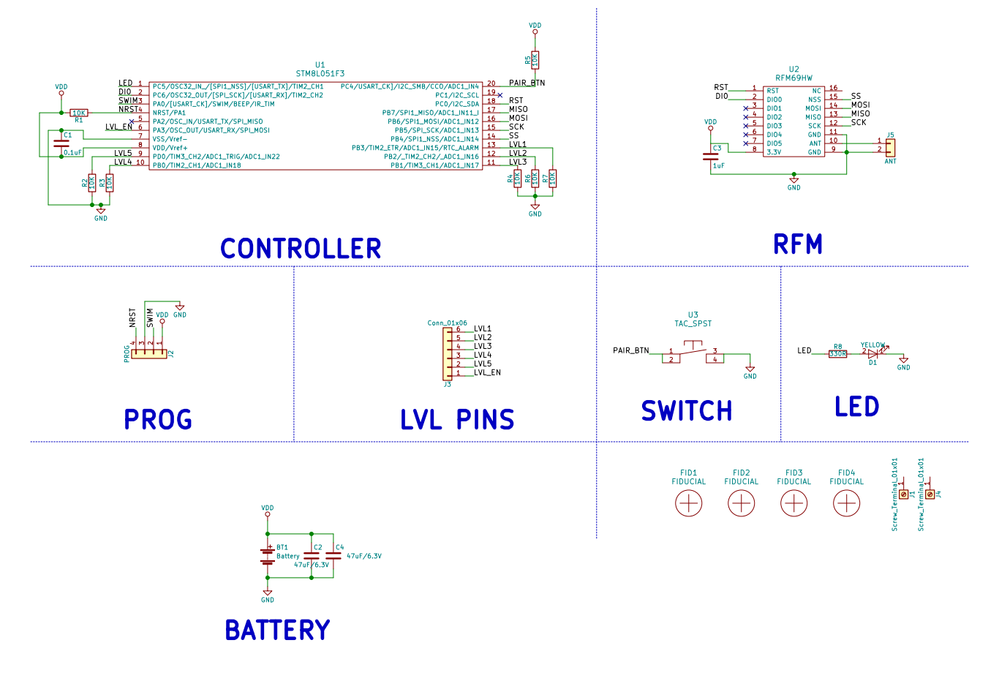

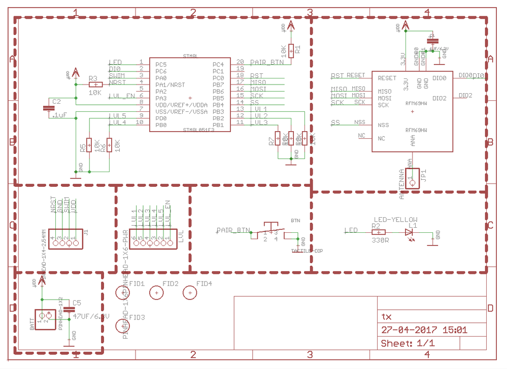

Thank you for your reply.This isthe schematic for the transmitter which employees a STM8L micro controller for its operation.
The is the full schematic design.
In the design of the transmitter, there is no functional change. The board size has been changed to fit into a new enclosure,whereby the layout has been changed.
Project 1
This is the old schematic (the working and deployed version):
This is the new schematic (version which has the issue):

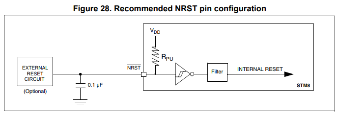

According to the datasheet we need not put a pull up resistor for the NRST pin. Thoughthe former
design
worked flawlessly with the pull up on NRST, the latter didn't.
To rule out this mistake, we tweaked the design:
  1. removed the pull up resistor on NRST (kept it open) and checked the working of the board. Still the board shows the same behaviour.
  2. removed the pull up resistor on NRST (kept it closed) and checked the working of the board. Stillfailed.
  3. removed the pull up resistor and connected a 0.1µF capacitor to match the design on the datasheet. Still failed. In this case the board didn't reset abruptly but the current consumption was very high (0.5mA to 3mA).

We tried making three to four boards from different vendors from different parts of the world, to rule out the manufacturing defects. This didn't pay off, the board still has the same issue. We are looking into the layout too. We recently switched to KiCad from Eagle. The previous desing was on Eagle while the second design is on KiCad. Hope that isn't the cause of the issues.
Thank You.
