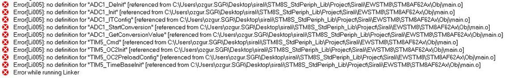

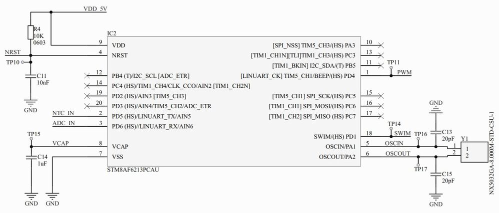

I am using STM8AF6213 MCU in my project. I am using PD6 (AIN6) pin to read analog value. I use PD4 (TIM5_CH1) to generate PWM. But the stm8_adc1.h and stm8_tim5.h libraries that I included in my project do not work properly. It does not see the functions in the library.

#include <stm8s_adc1.h>

  GPIO_Init(GPIOD, GPIO_PIN_6, GPIO_MODE_IN_FL_NO_IT);
  ADC1_DeInit();
  ADC1_Init(ADC1_CONVERSIONMODE_SINGLE, ADC1_CHANNEL_6, ADC1_PRESSEL_FCPU_D2, \
  ADC1_EXTTRIG_TIM, DISABLE, ADC1_ALIGN_RIGHT, ADC1_SCHMITTTRIG_CHANNEL8,\
  DISABLE);
  ADC1_ITConfig(ENABLE,DISABLE);
  ADC1_StartConversion();
